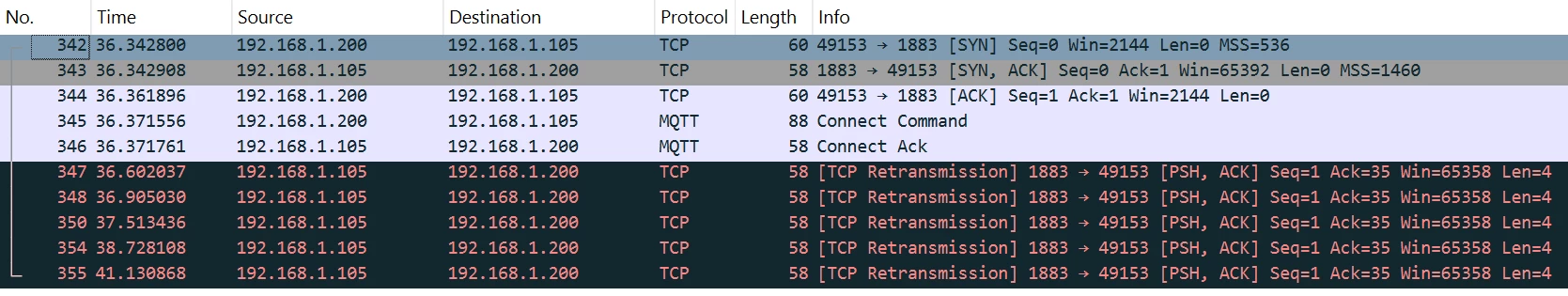

I'm trying to implement the lwip + paho mqtt (embedded version) on a nucleo-f207zg board, following this project :
https://blog.naver.com/eziya76/221938551688

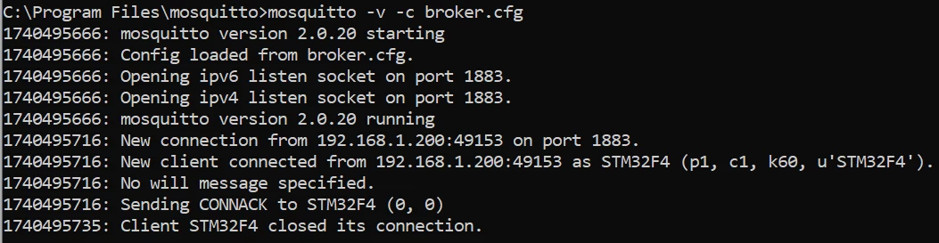

I have a mosquitto broker and wireshark on a windows computer.
Mosquitto started with command :
mosquitto -v -c broker.cfg
broker.cfg file content :
listener 1883
allow_anonymous true
Windows IP : 192.168.1.105
STM32 IP : 192.168.1.200
Both IP are static. The ETH link is ok, I can ping the STM32. I'm blocked since a few day on the connection to the MQTT broker.
ConnectNetwork() works, but MQTTConnect() don't.
The STM32 send the request, mosquitto receive it and CONNACK but the STM32 don't received it and abort the connection.
I think I have localized the issue, but I can't resolve it with my limited knowledge in network programming.
MqttConnectBroker() => MQTTConnect() => MQTTConnectWithResults()
This function make the following call to waitfor() :
 ret = waitfor(c, CONNACK, &connect_timer);

waitfor() always return -1. Looking into this function :
int waitfor(MQTTClient* c, int packet_type, Timer* timer)
 int rc = FAILURE;
 do
 if (TimerIsExpired(timer))
 break; // we timed out
 rc = cycle(c, timer);
 while (rc != packet_type && rc >= 0);
 return rc;
There is no timeout, but cycle() returns -1.

packet_type = -1, so I always go to the default case, exit with an error code making the STM32 disconnect from the host.
I also have a SWV trace with LWIP debug + some high level debug (see below)
Any help will be strongly appreciated :)
Thanks

Solved !
LWIP_SO_RCVBUF was not enabled...
