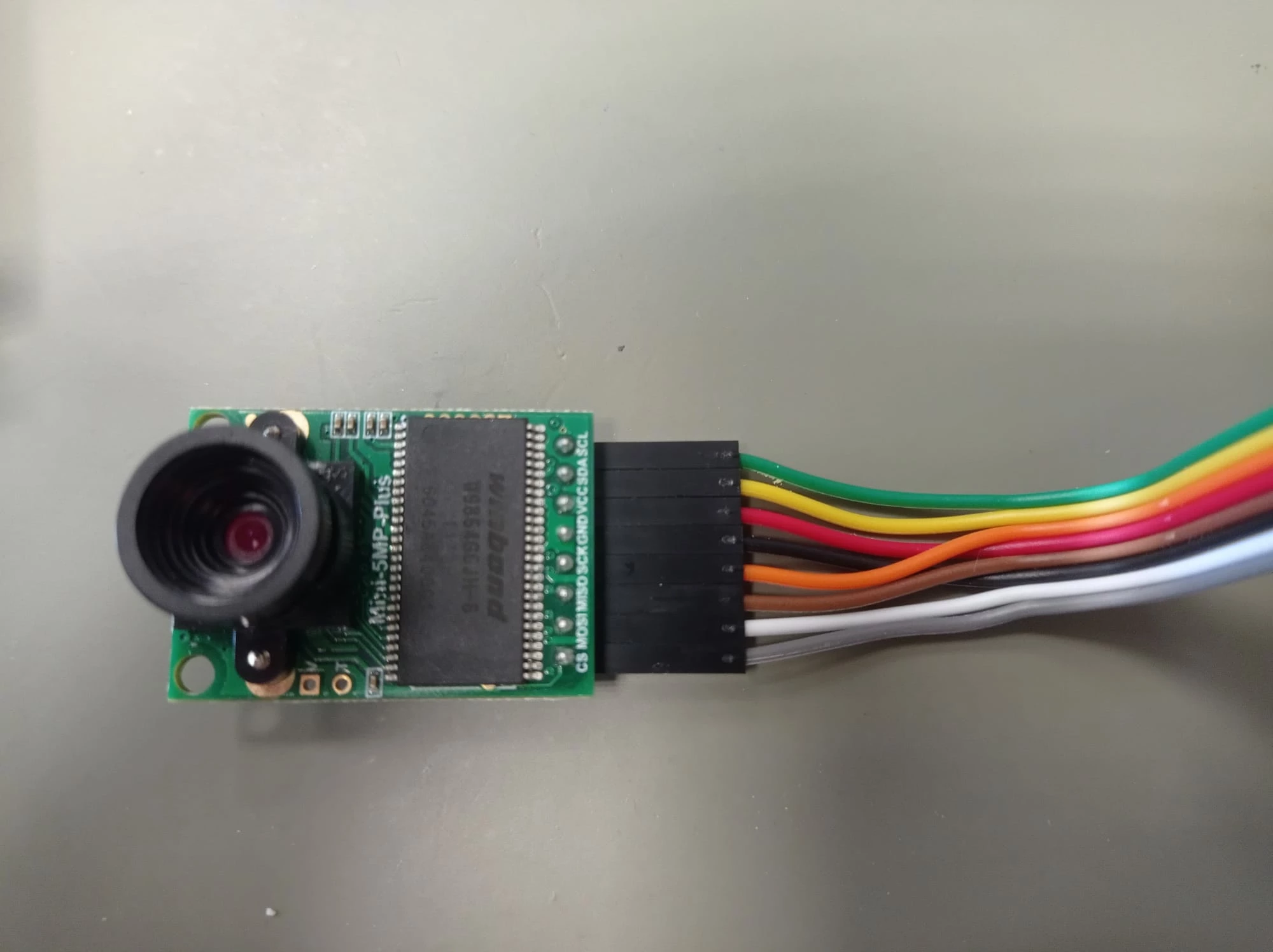

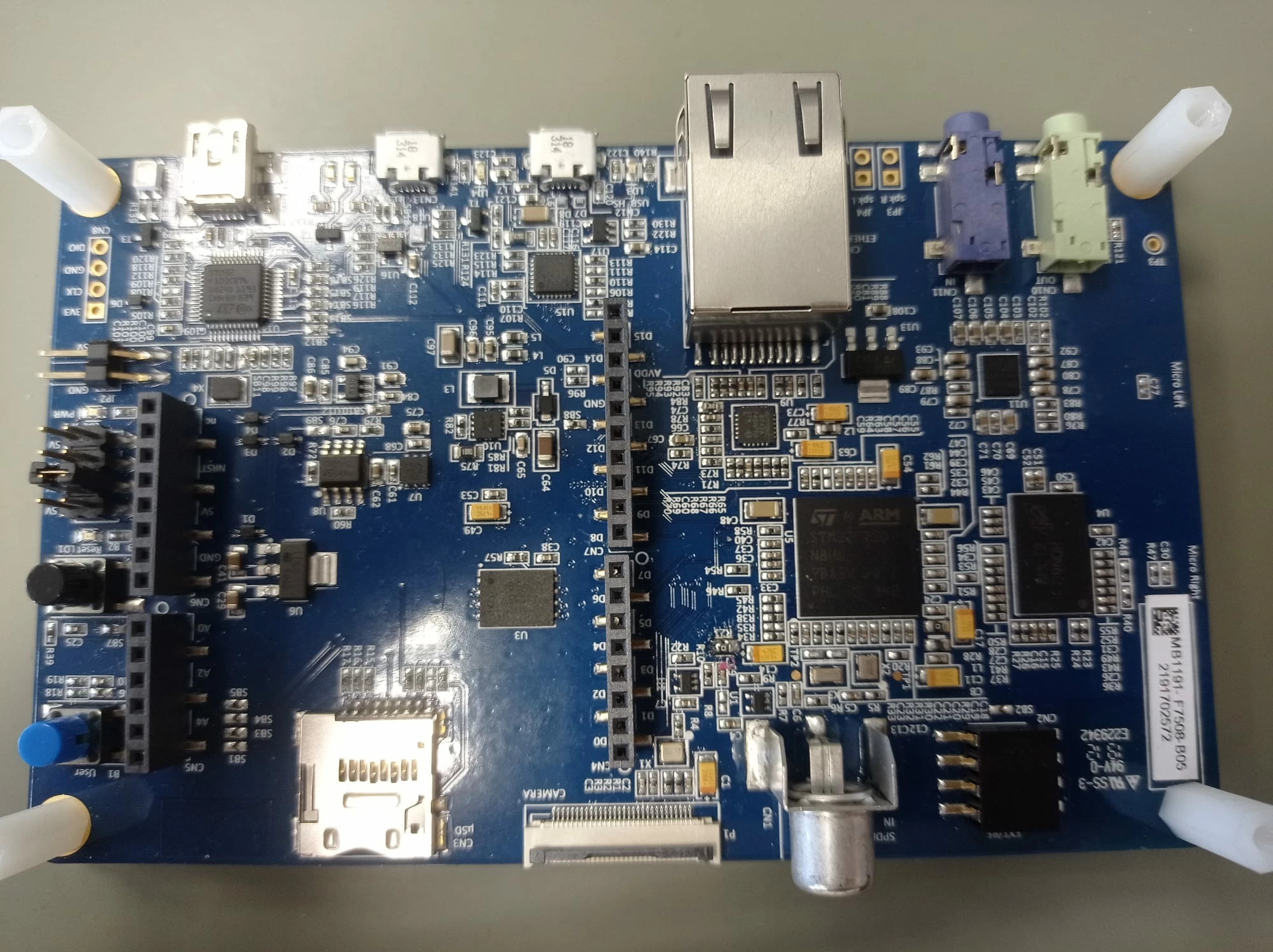

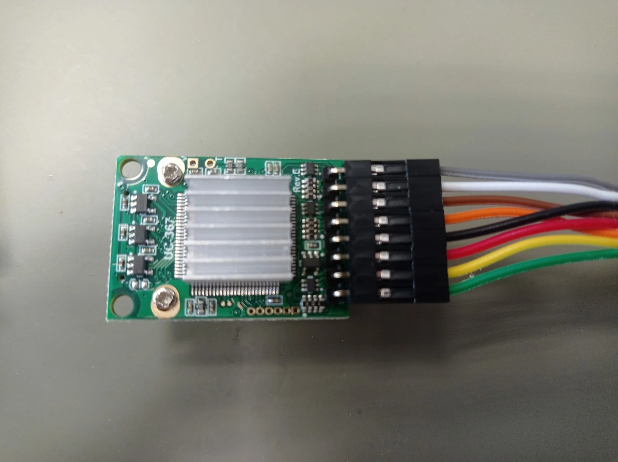

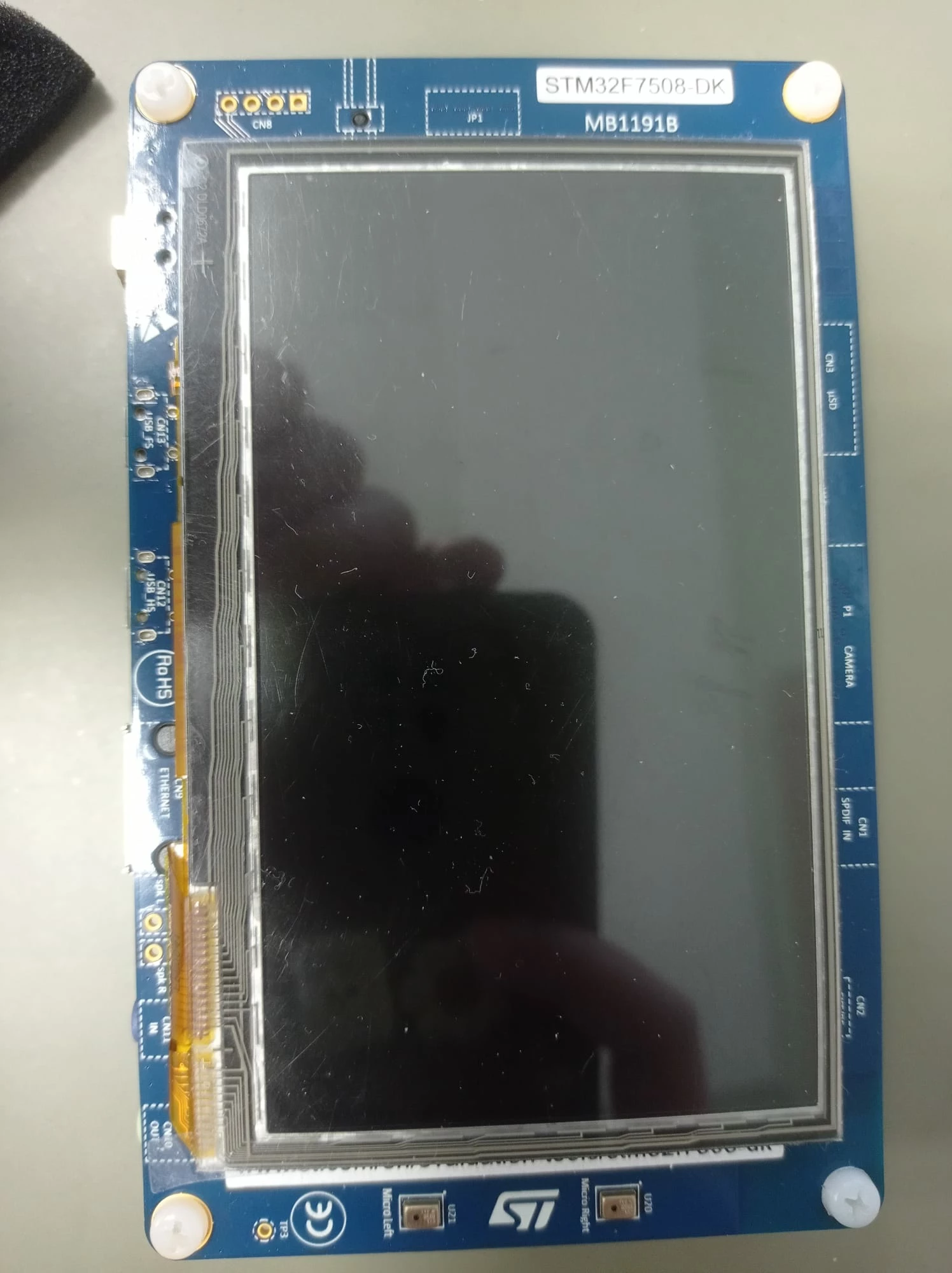

I want to use the OV5642 camera with the STM32F7508-DK card and display the image I take from the camera on the LCD screen on the card.
WhatsApp Görsel 2024-03-19 saat 10.07.54_dbf6842d.jpgWhatsApp Görsel 2024-03-19 saat 10.28.24_d99aa8e0.jpg
WhatsApp Görsel 2024-03-19 saat 10.07.54_d9e655b0.jpgWhatsApp Görsel 2024-03-19 saat 10.07.54_4fd2525c.jpg
Is this possible? If it is possible, can you help me how to do this?

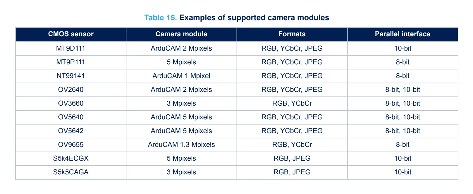

Hello @Sule_Akcay ,
It is mentioned in AN5020 "Introduction to digital camera interface (DCMI) for STM32 MCUs" that OV5642 as an ArduCAM 5 Megapixels camera module compatible with STM32 DCMI.
For the connection between the camera module and STM32F7508-DK, I advise you to refer to the camera module datasheet and to board schematic. Note that this board has an "External Camera connector".

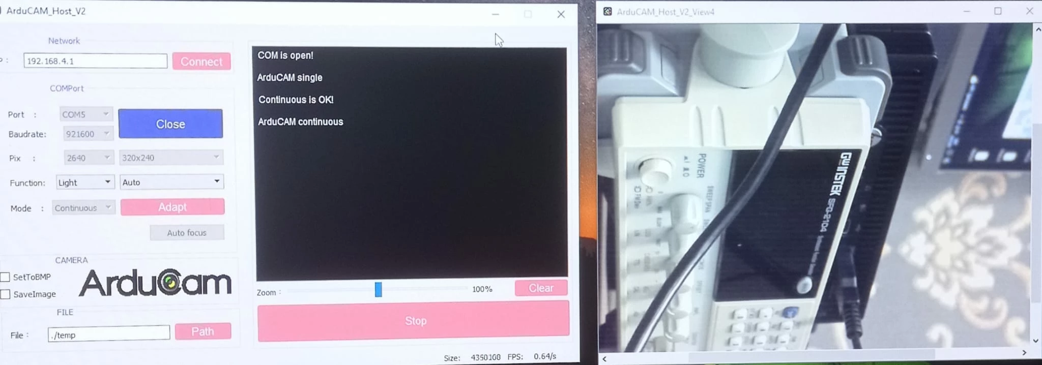

Mar 25, 2024 11:10 AM UTC
I found a sample application of the OV5642 camera module for the STM32F103C8T6 chip. However, I had difficulty adapting this code example to the STM32F7508-DK development board. Is there anyone who can help on this issue?
OV5642 camera module example application code for STM32F103C8T6 chip:

Program output:
