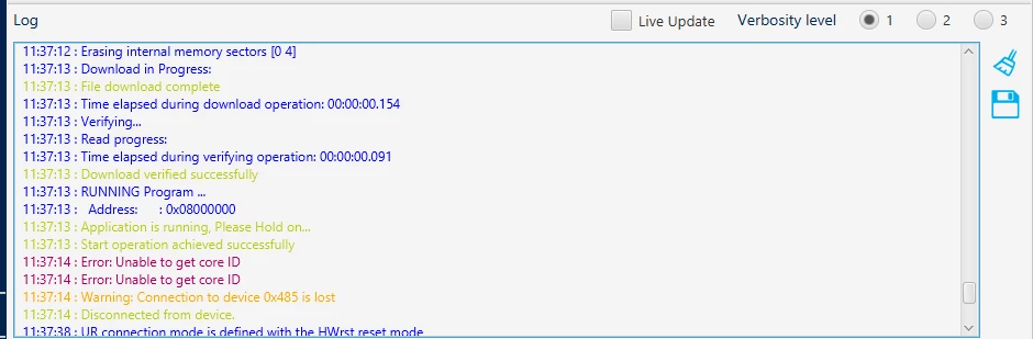

  • STM32CubeProgrammer successfully downloads and verifies the  customboot.elf at internal flash
  • The instant the core starts running, the board disconnects from ST-LINK:
  • The LCD stays black, and STM32CubeProgrammer cannot reconnect in Normal mode. Can able to connect in Under reset mode
  • Conversely, if we flash an unmodified TouchGFX Designer demo, the board boots and runs normally.
    Note : I also tried the Boot.elf which is not modified, flashing through STM32CubeProgrammer causes me same problem as customboot.elf

    • Why does accessing or attempting to read external memory before Boot_Application(), cause a severe bus fault that terminates the SWD connection (Error: Unable to get core ID)?
    • why even flashing unchanged / defualt boot.elf is causing the same problem . i don’t know what the real problem is.

Since even the unmodified Boot.elf causes the same issue, I'd first investigate the boot configuration and startup sequence before focusing on OTA logic. Check the XSPI initialization, boot address, and debugger connection settings. Have you tried debugging the bootloader step by step to identify exactly where the core loses connection?
Nov 3, 2026 7:00 PM UTC
 Hi @juliawhites,
