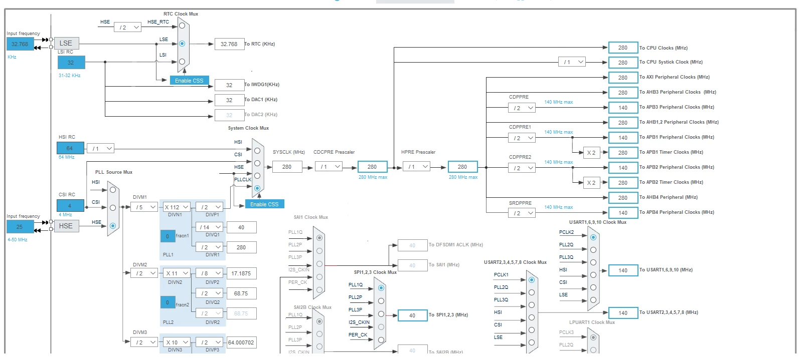

What is your MCU core clock source and rate? Have you used CubeMX/IDE to generate clock setup code?
KAgga.1
KAgga.1Author
Feb 14, 2024 5:19 AM UTC
Yes I used CubeIDE. Below is the clock configuration.
