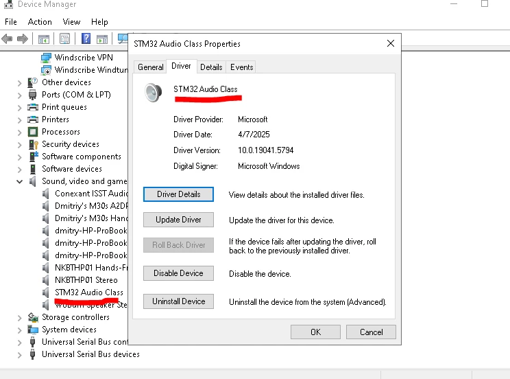

I am trying to get  STM32H743iit as usb_audio_device with CubeMX latest version.
No initialization of stm32 sound device in windows 10 device manager.
Other projects from this link  https://www.waveshare.com/wiki/OpenH743I-C  especially USB_FS, USB_HS working good, but in windows devise manager  no descriptors info in usb device properties windows for HID project. Could somebody help where i am got problem with usb_audio_device? I change VID, heap size but it is do not help.

Hi @Dmitriy_777
Can you provide your full software setup for usb_audio_device?
To give better visibility on the answered topics, please click on "Best answer" on the reply which solved your issue or answered your question.Best regards,FBL

Already done for initialization of 2 ch USB_FS, at least we got STM32 Audio class in device manger.

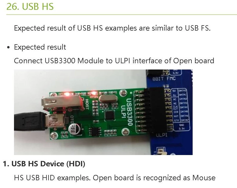

Actually i need RX 4ch, TDM, 16 bit, 48000Hz.  Most probably it will be USB_HS?
Could you please give recommendation for MX config for this,  TLV320adc5140 4 mic CH -- SAI   -ping-pong buffer -- USB_FS_RP4/5.

i got this one for USB_HS. do You think we will succeeded?
