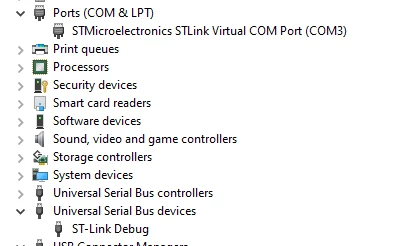

4. Driver Installed :
en.stsw-link009 and Virtual Com port : VCP_V1.5.0_Setup_W8_x64

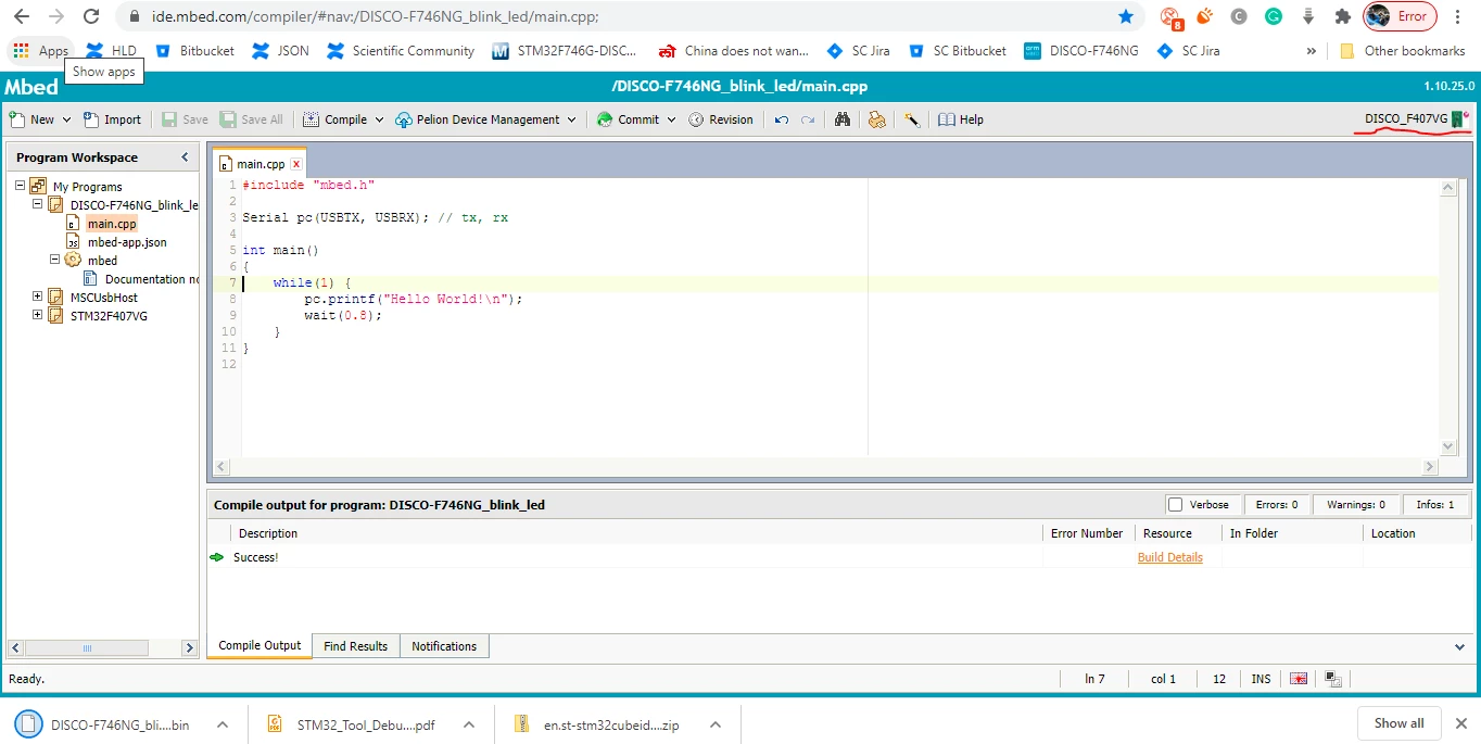

5. Coding Using MBED online compiler.

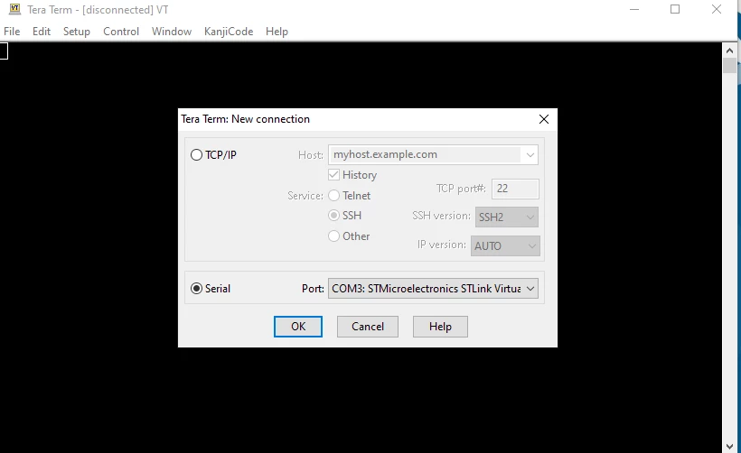

Issue : When I access COM3 port using Tera Term / putty it shows me blank screen,
Why it don't print Helllo World on putty or Teram Term console ???

Code :
#include "mbed.h"
Serial pc(USBTX, USBRX); // tx, rx
int main()
while(1) {
pc.printf("Hello World!\n");
wait(0.8);
Kindly refer below screen snaps of Virtual Com Port, Tera term and Code for more detail.
