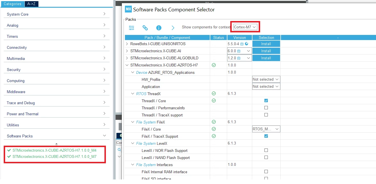

I noticed that only CM4 is selected in the Azure Software Pack and you did not select CM7.
If you want to use CM7, you need to configure it in the software pack as well.
The following image shows how to select the required core.
0693W000008z0LwQAI.pngI have attached an ioc file showing an example that uses both CM4 and CM7.
I hope this helps! Please mark my post as Best Answer using the button below in case it solved your issue.

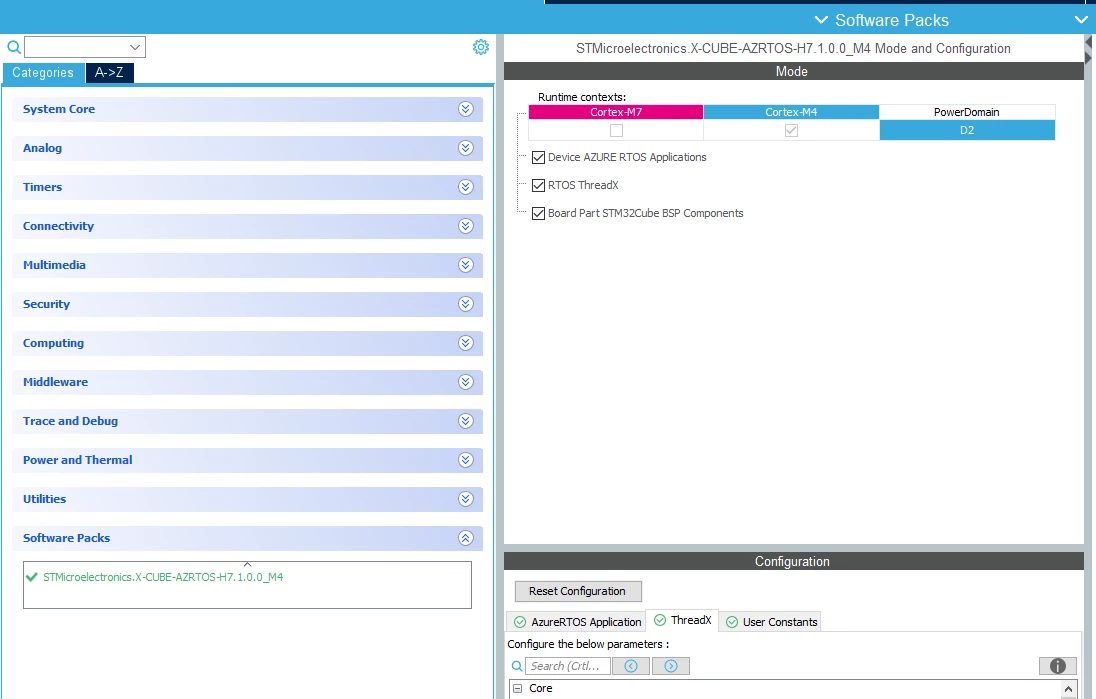

CIsel.1Author
April 7, 2021
0693W000008yvyAQAQ.pngDear Walid,
Thank you for your message. My issue is that I can activate AzureRTOS only on one of the 2 cores. For example I just started over with the H747-DISCO board, initializing all peripherals, then select Azure software pack. Now when configuring the Azure Software pack only CM4 is selected and I cannot select CM7, see attached image.
What am I missing ?
Kind regards,
Christian

CIsel.1Author
April 8, 2021
Indeed, I completely missed the core selector you mentioned.
Problem solved, thanks a lot
Kind regards,
Christian
