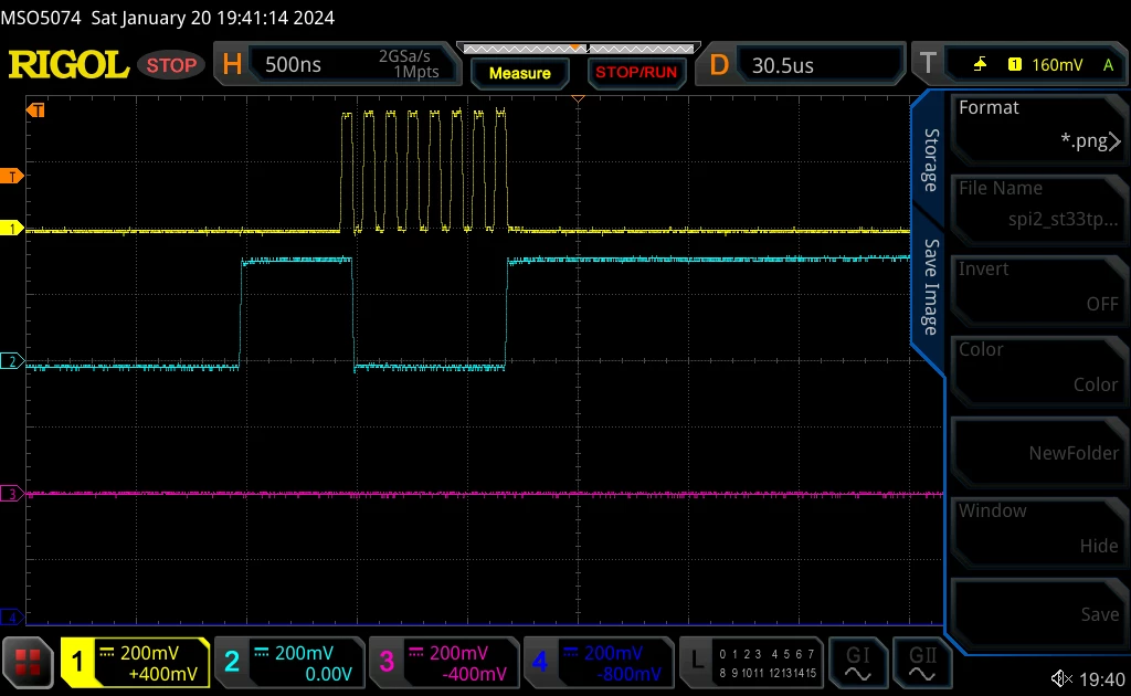

To the point - I see communication on SPI2 is initiated - first transaction is visible on the lines. There are 3 phases for transaction:
-4 bytes TX (80 D4 00 00) /RX
-polling for wait states - in my case just single byte is TX/RX but wait flag is not seen.
-confirmation byte.
Then, next transaction is initiated, its exactly the same like the first one. But just SINGLE BYTE is transmitted (0x80) and that's it, bus is silent. When debugging I see that for both transactions the same data is feeded to HAL_SPI_TransmitReceive().

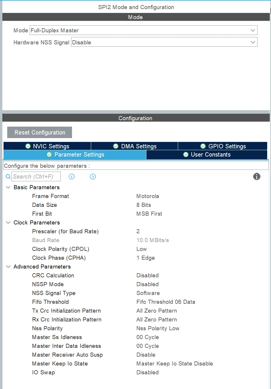

SPI2 setup:

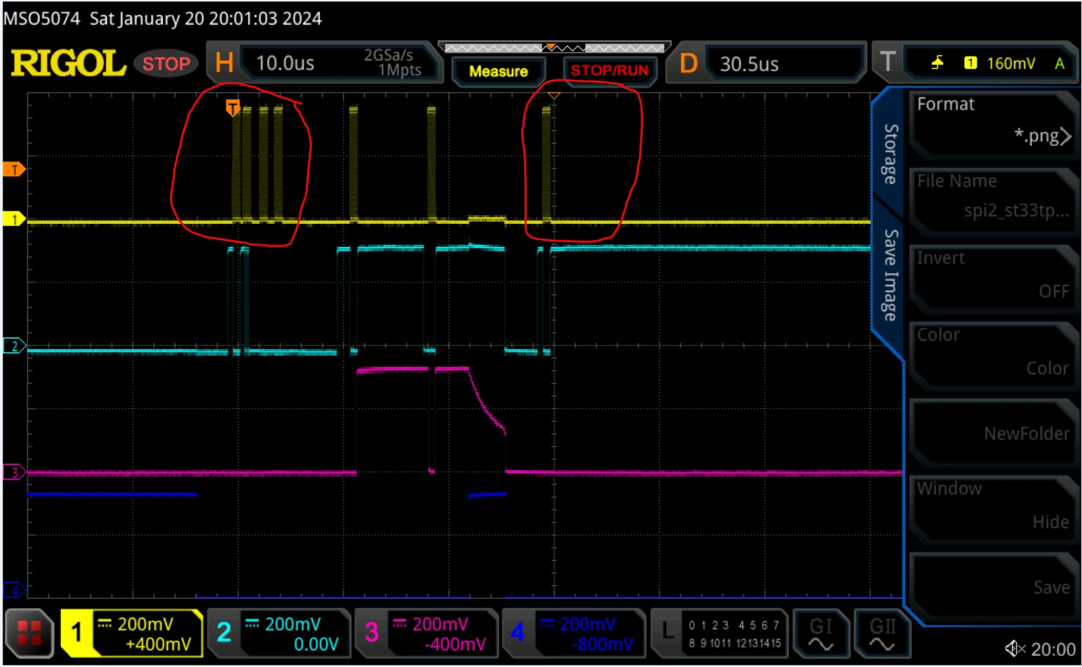

Overall traffic until TRX is gone (red circles mark where same TRX of 4 bytes should be visible):

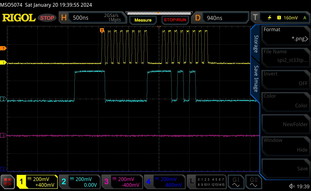

Zoom in to first 2 bytes (correct behavior):
Zoom in to second transaction (NOK, just first byte is sent):

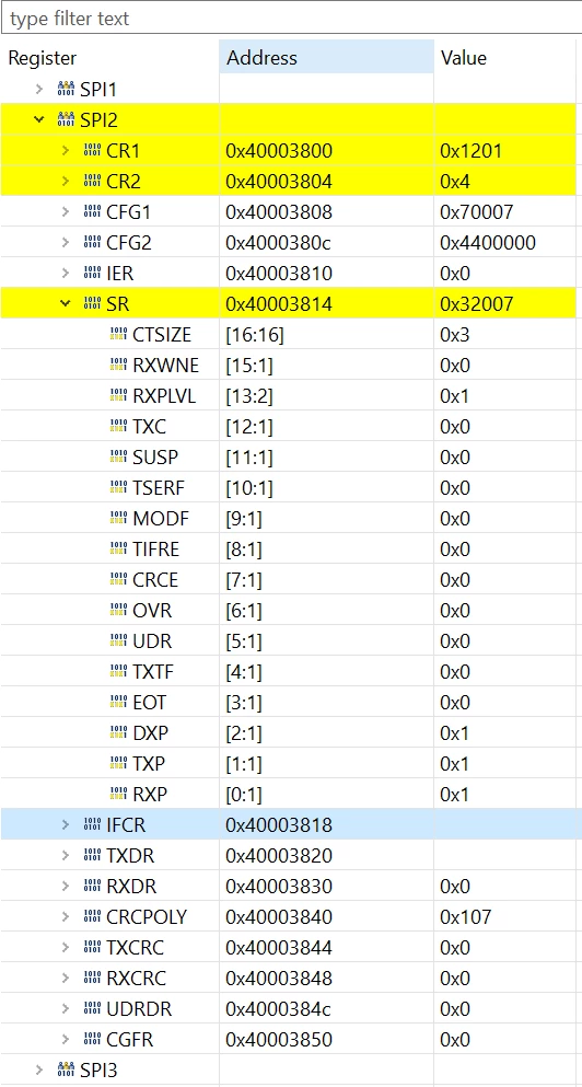

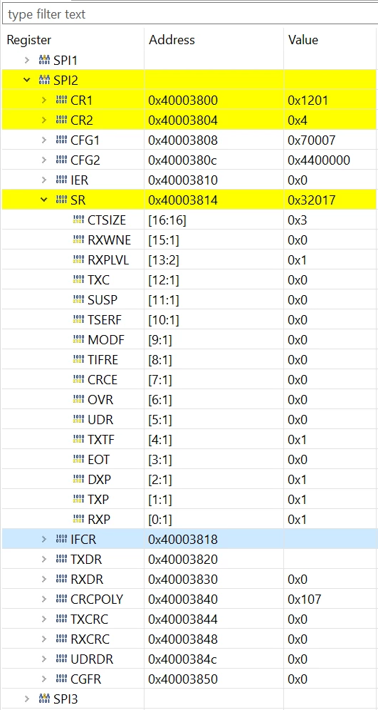

I also include 2 screenshots with state of all SPI2 registers in the moment (breakpoint stop) before HAL_SPI_TransmitReceive() is loading SECOND byte to TXDR for first and second transaction to see the difference. It is just one flag: TXTF which is set on second transaction but not on the first one.
First time:
Second time:

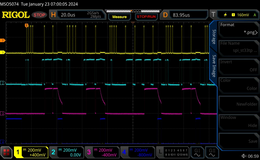

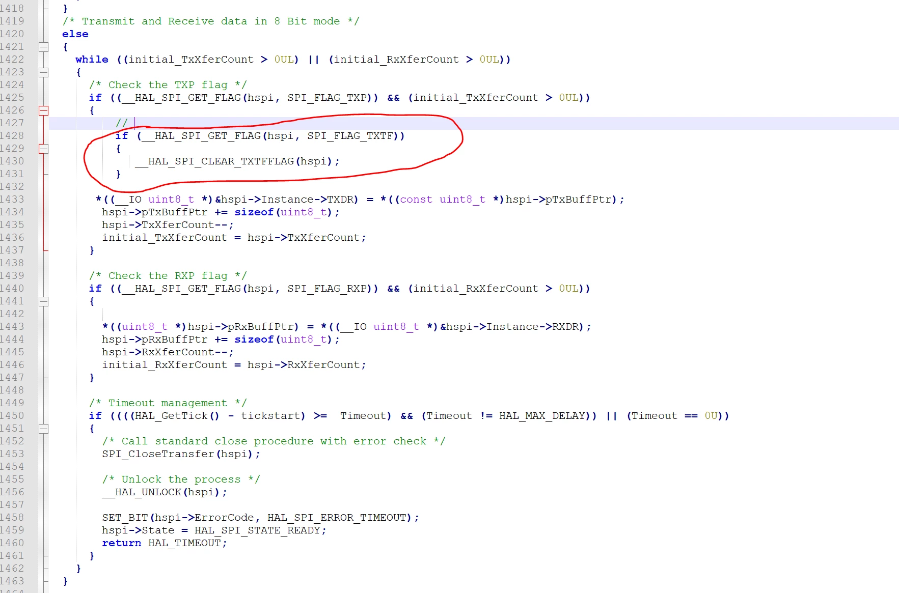

Update!
I followed observed difference in SPI transaction 1 and 2 -> TXTF flag. When I clear TXTF flag, see below in red, in HAL_SPI_TransmitReceive() function, then I unlock transmission to go on; it seems working fine, will check more tomorrow. It is ad hoc experiment, more checks needed but at least traffic continues...
And screenshot from the scope :)

Jan 31, 2024 5:01 PM UTC
Hello again
It seems that such simple fix helped me to get rid of the problem reported above. Now I concentrate on funcitonality itself of the SW stack behind ST33TP.
Nevertheless, the issue with unhandled TXTF flag, while HAL_SPI_TransmitReceive() is executing, which is blocking further  transmission until clearance, is not the expected behavior of SPI driver. If so, shouldn't this issue be taken over by HAL supporting staff to deeper investigation and potential bug fixing?
