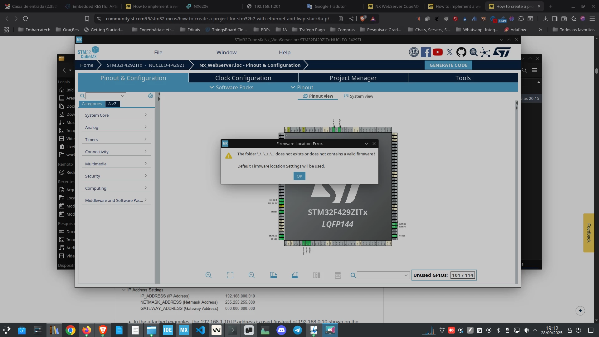

This error is happening when I load the project into CubeMX for the first time.carlosdelfino_0-1759097642723.png

Oct 2, 2025 1:38 PM UTC
Hello @carlosdelfino,
Did you install your F4 firmware in a location other than the default one? Have you tried removing both the project and the firmware, then reinstalling them in the default location?
Regarding the DHCP issue, have you ensured that a DHCP server is running on your computer? If not, you should connect the board directly to the router so it can be assigned an IP address. Additionally, have you tried monitoring the network traffic using a tool like Wireshark? This can help determine if the DHCP sequence stops at a certain step or does not occur at all.

Oct 3, 2025 6:19 PM UTC
Hello, thank you for your attention.
I've already tried removing and creating the project, but I always get this error. I'll try removing the firmware and reinstalling it. I'll also try removing everything and reinstalling everything. I use Linux and have never had similar problems. Strangely, the compilation works, but the code seems empty in terms of the example's purpose.
I'll get back to you later today.
