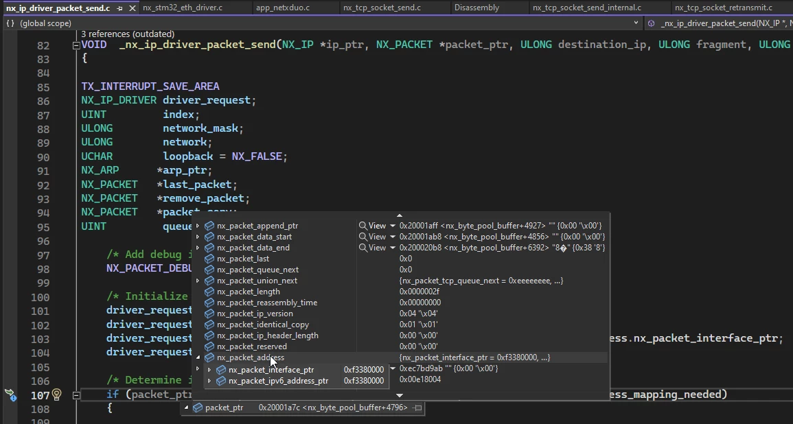

i am developing an embedded software based on the TCP Client example for CubeMX. During tests with large number of packets I have got an hard fault error. It seems that it happens on a re-transmit. The hard fault can be easy reproduced with original code. For this the right IP address must be set. Also the packet count should be increased to have time to remove the LAN cable while running.
The Project was setup like this:
My only modification:
#define TCP_SERVER_ADDRESS IP_ADDRESS(192, 168, 0, 213)
#define MAX_PACKET_COUNT 10000
Here a screenshot:
It seems that a pointer gets damaged as the address 0xF338000 makes no sense.

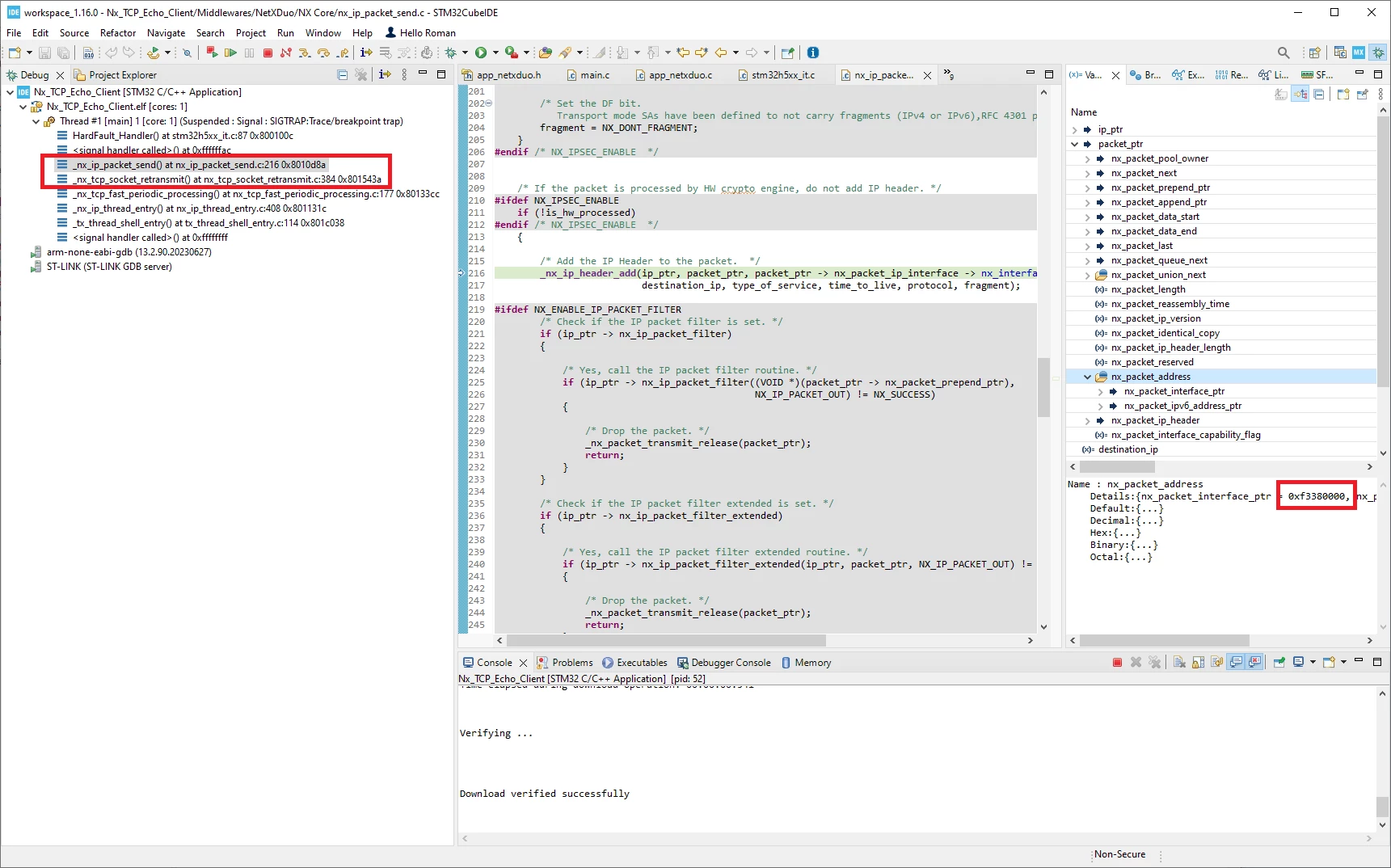

I have take a closer look to the problem. I thing something is wrong with the re-transmit handling.
Here is the problem:
1)  A packet of type NX_PACKET is send using nx_tcp_socket_send()
2)  After a few calls the function _nx_driver_packet_send() is called. Inside that function the packet structure is overwritten to build the massage header. See here:
2024_09_24_10_51_23_TCPClient_Debugging_Microsoft_Visual_Studio.png4) After a timeout, the pointer to the now damaged NX_PACKET structure is used for a re-transmit in the function _nx_tcp_socket_retransmit()
5) In the function _nx_ip_driver_packet_send() the pointer access will fail. See here:
Seems to be major issue in the re-transmit process of NetX. I'm surprised that no one has ever noticed that. Doesn't anyone ever pull the plug during data transmission? Happy path programming is only a small part of the job.
