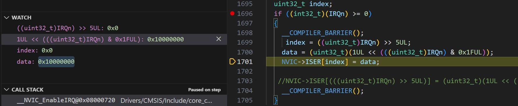

I'm learning to port FreeRTOS to my STM32F407, but I'm running into problems with HAL initializing TIM2.
After HAL_OK the program is supposed to enable TIM2IRQ via NVIC_EnableIRQ(), but the operation of writing to NVIC->ISER doesn't seem to work.
NVIC->ISER[(((uint32_t)IRQn) >> 5UL)] = (uint32_t)(1UL << (((uint32_t)IRQn) & 0x1FUL));
So I followed this post and modified 'CMSIS\Include\core_cm4.h', but again it didn't work.
 uint32_t data;
 uint32_t index;
 if ((int32_t)(IRQn) >= 0)
 __COMPILER_BARRIER();
 index = ((uint32_t)IRQn) >> 5UL;
 data = (uint32_t)(1UL << (((uint32_t)IRQn) & 0x1FUL));
 NVIC->ISER[index] = data;
My debugger won't continue after this expression, any ideas?

@Jemegen Please, show the actual code. What means "after HAL_OK"?

HAL_OK is the return value of HAL_TIM_Base_Init() in HAL_InitTick()
Core\Src\stm32f4xx_hal_timebase_tim.c:
 htim2.Init.Period = (1000000U / 1000U) - 1U;
 htim2.Init.Prescaler = uwPrescalerValue;
 htim2.Init.ClockDivision = 0;
 htim2.Init.CounterMode = TIM_COUNTERMODE_UP;
 htim2.Init.AutoReloadPreload = TIM_AUTORELOAD_PRELOAD_DISABLE;
 status = HAL_TIM_Base_Init(&htim2);
 if (status == HAL_OK)
 /* Start the TIM time Base generation in interrupt mode */
 status = HAL_TIM_Base_Start_IT(&htim2);
 /* Enable the TIM2 global Interrupt */
 HAL_NVIC_EnableIRQ(TIM2_IRQn);
 /* Configure the SysTick IRQ priority */
 if (TickPriority < (1UL << __NVIC_PRIO_BITS))
 /* Configure the TIM IRQ priority */
 HAL_NVIC_SetPriority(TIM2_IRQn, TickPriority, 0U);
 uwTickPrio = TickPriority;
 else
 status = HAL_ERROR;
 /* Return function status */
 return status;
HAL_NVIC_EnableIRQ(TIM2_IRQn) calls NVIC_EnableIRQ(), which is __NVIC_EnableIRQ()
Drivers\STM32F4xx_HAL_Driver\Src\stm32f4xx_hal_cortex.c:
void HAL_NVIC_EnableIRQ(IRQn_Type IRQn)
 /* Check the parameters */
 assert_param(IS_NVIC_DEVICE_IRQ(IRQn));
 /* Enable interrupt */
 //NVIC_SetVector(TIM2_IRQn, TIM2_BASE);
 NVIC_EnableIRQ(IRQn);
These are the code generated by HAL and I don't understand what is wrong. HAL_Init() in main() is the first to perform peripheral initialization.
