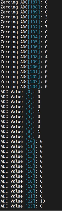

NUCLEOL152RE board adc_buffer not being written to
The ADC buffer is not being written to I would like it to zero all values less than 5 to eliminate noise. My project is a DTMF detector. I need it to pass through audio when no DTMF tone is detected and execute a command when there is one found. Also please assist with the pass-through function that is not working either

for (int i = 0; i < BLOCK_SIZE; i++) {
if (adc_buffer[i] < NOISE_THRESHOLD) {
char debug_msg[50];
snprintf(debug_msg, sizeof(debug_msg), "Zeroing ADC[%d]: %u\r\n", i, adc_buffer[i]);
HAL_UART_Transmit(&huart2, (uint8_t*)debug_msg, strlen(debug_msg), HAL_MAX_DELAY);
adc_buffer[i] = 0; //
print_adc_values();
strcpy(message5, "callback \n \r");
HAL_UART_Transmit(&huart2,(uint8_t*)message5,sizeof(message5),100);
