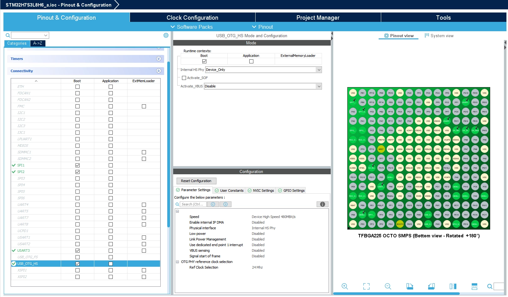

I recently purchased a Nucleo STM32H7S3L8 board, and it is giving me problems.
I am using STM32CUBEIde to create a usb host and a CDC class.
I am using the x-cube-tcpp module, USB_OTH_HS and the problem is that the usb host does not initialize. It stops at the USB_CoreReset function,
exactly USBx->GRSTCTL is always 1, it doesn't change.
Can anybody help me?

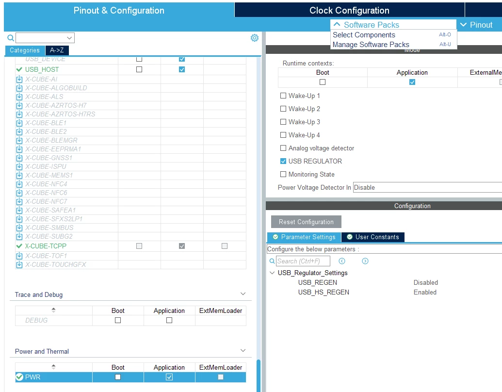

Hi Everyone,
I was able to get it to work if you update: USB_HS_REGEN to 'enabled' under the power and thermal tab

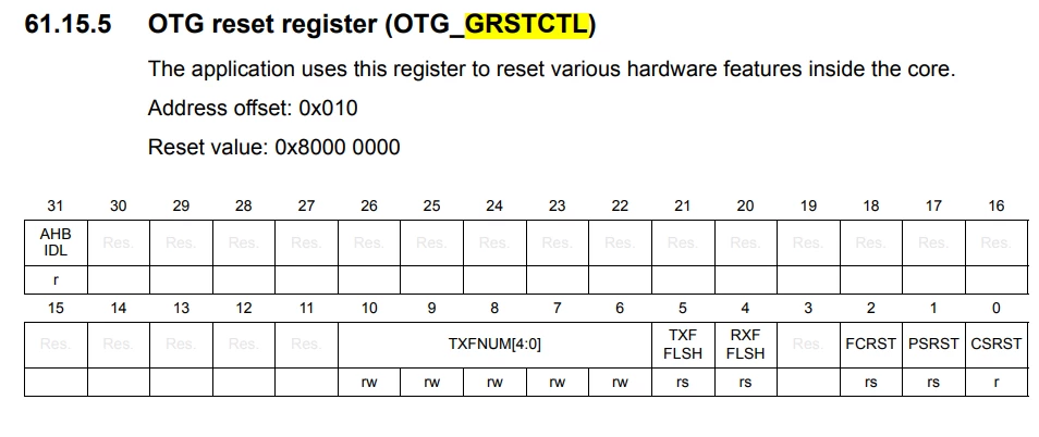

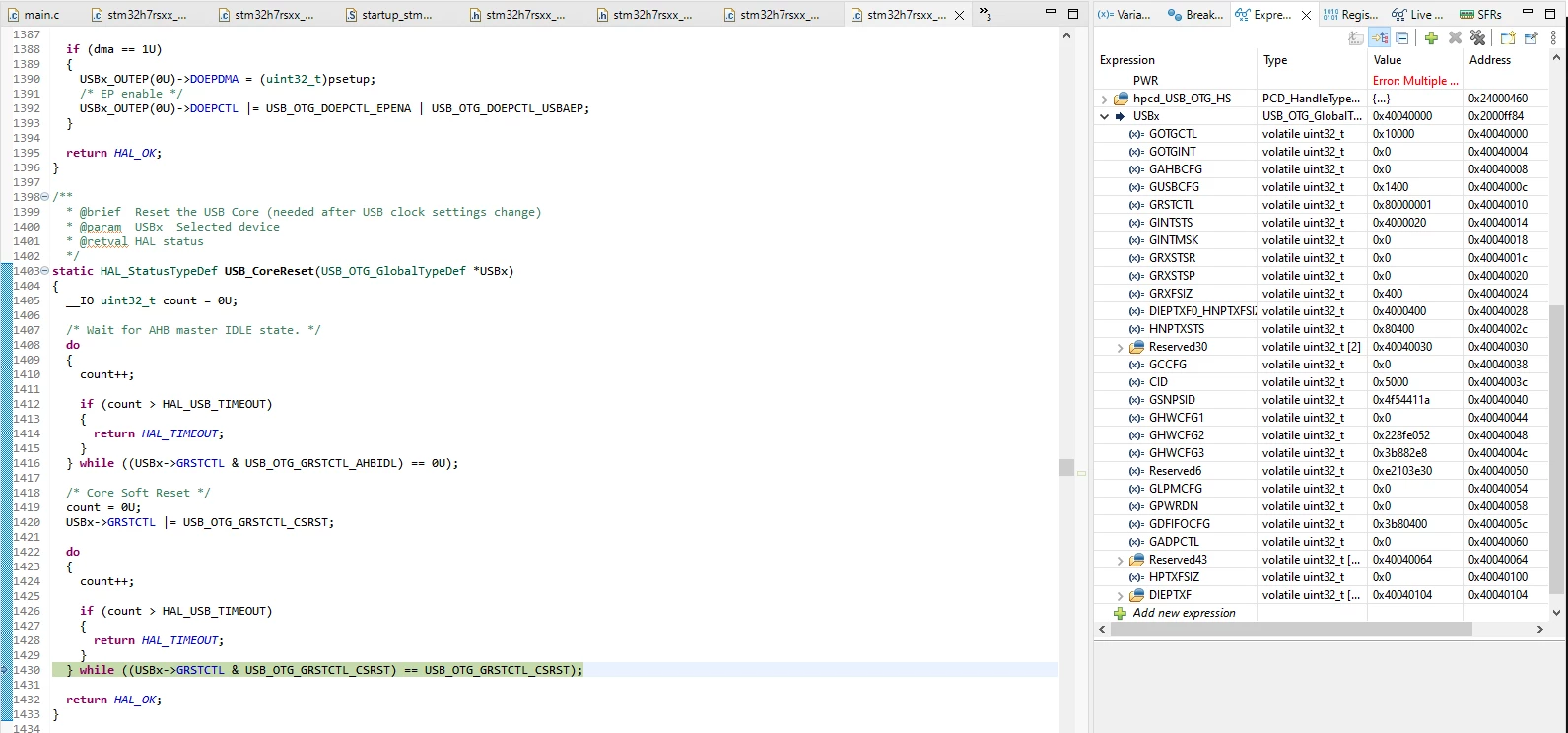

I am experiencing the same issue on the NUCLEO-H7S3L8.
USB_OTG_GRSTCTL_CSRST is stuck to 1
During usb configuration/initialisation
static HAL_StatusTypeDef USB_CoreReset(USB_OTG_GlobalTypeDef *USBx)
__IO uint32_t count = 0U;
/* Wait for AHB master IDLE state. */
do
count++;
if (count > HAL_USB_TIMEOUT)
return HAL_TIMEOUT;
} while ((USBx->GRSTCTL & USB_OTG_GRSTCTL_AHBIDL) == 0U);
/* Core Soft Reset */
count = 0U;
USBx->GRSTCTL |= USB_OTG_GRSTCTL_CSRST;
do
count++;
return HAL_TIMEOUT;
} while ((USBx->GRSTCTL & USB_OTG_GRSTCTL_CSRST) == USB_OTG_GRSTCTL_CSRST); //<<< Never leaves this state!!!
return HAL_OK;
Can someone help with the above?
Thanks
Harry

Hello @JaimeLujanLozano  & @Harry_S
I reproduced the issue on my side too and reported it to dedicated team. It seems the configuration of USB core in both instances is not correct after code generation. In fact, BSVLD bit field should be set in OTG_GOTGCTL.
Internal ticket number 180898

Jun 14, 2024 9:27 PM UTC
Hi Everyone,
