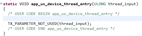

I observe, that CubeIDE 1.12 does not generate all code necessary to make CDC-ACM work.
_legacyfs_online_stmicro_images_0693W00000bjTRJQA2.pngA complete folder is missing here
usbx_STM32_device_controllers
In addition
in the user application ux device thread there is no initialization of the Hardware driver
_legacyfs_online_stmicro_images_0693W00000bjTSHQA2.pngIt is missing this:
static VOID app_ux_device_thread_entry(ULONG thread_input)
 /* USER CODE BEGIN app_ux_device_thread_entry */
	USBX_APP_Device_Init();
 TX_PARAMETER_NOT_USED(thread_input);
 /* USER CODE END app_ux_device_thread_entry */

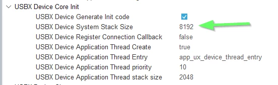

I also found out, that the memory settings in IOC file are too small:
the USBX System stack must be large enough, otherwise the USB Device initialization will fail with insuficient memory.

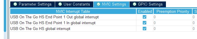

Function call to MX_USB_OTG_HS_PCD_Init should be disabled
and USB interrupts must be enabled

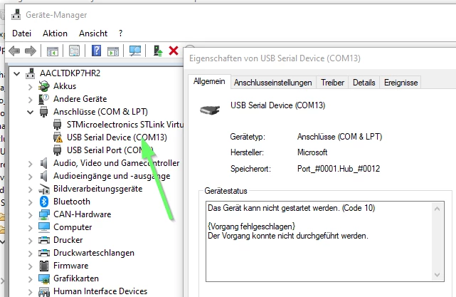

at least, a USB virtual port is displayed on myPC at the moment. But it still has errors. There is still some implementation missing.
"Driver cannot be started"

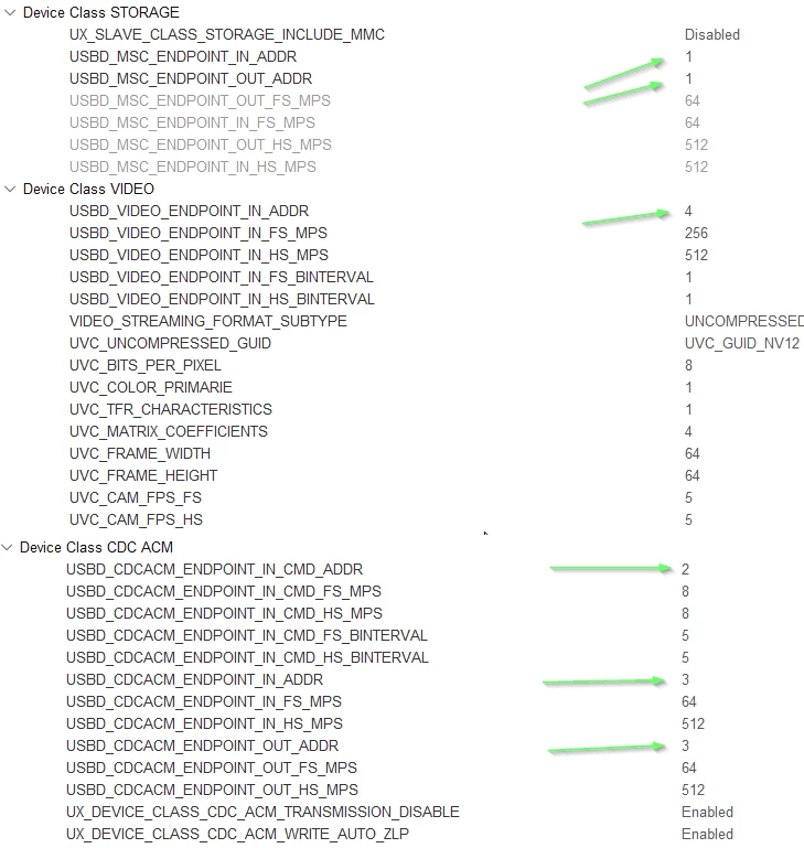

I found the answer for the driver error "cannot start driver code 10"
https://community.st.com/s/question/0D53W00001F0YM3SAN/azure-rtos-usbx-device-descriptor-errors?t=1683547709123
I needed to change the end point addresses in ux_device_descriptors.h
#define USBD_CDCACM_EPIN_ADDR 0x82U //changed from 0x81
#define USBD_CDCACM_EPOUT_ADDR 0x03U //changed from 0x01
I don't understand why this helps.

 found the answer myself.
In cubeIDE / cubeMX you have to define the usb endpoint adresses yourself. CubeMX does not do an automatic enumeration .
all endpoints must not overlap.
In-Endpoints are typically 0x80+n and output endpoints are 0x00+n
In and out of one element can have the same number.
In this example
MSC (mass storage) one in and one out (1, 0x81)
CDC-ACM (serial port) uses two endpoint groups
  • command (2)
  • Data (3, 0x83)
Video uses 4
