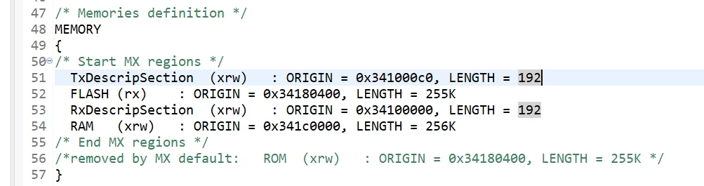

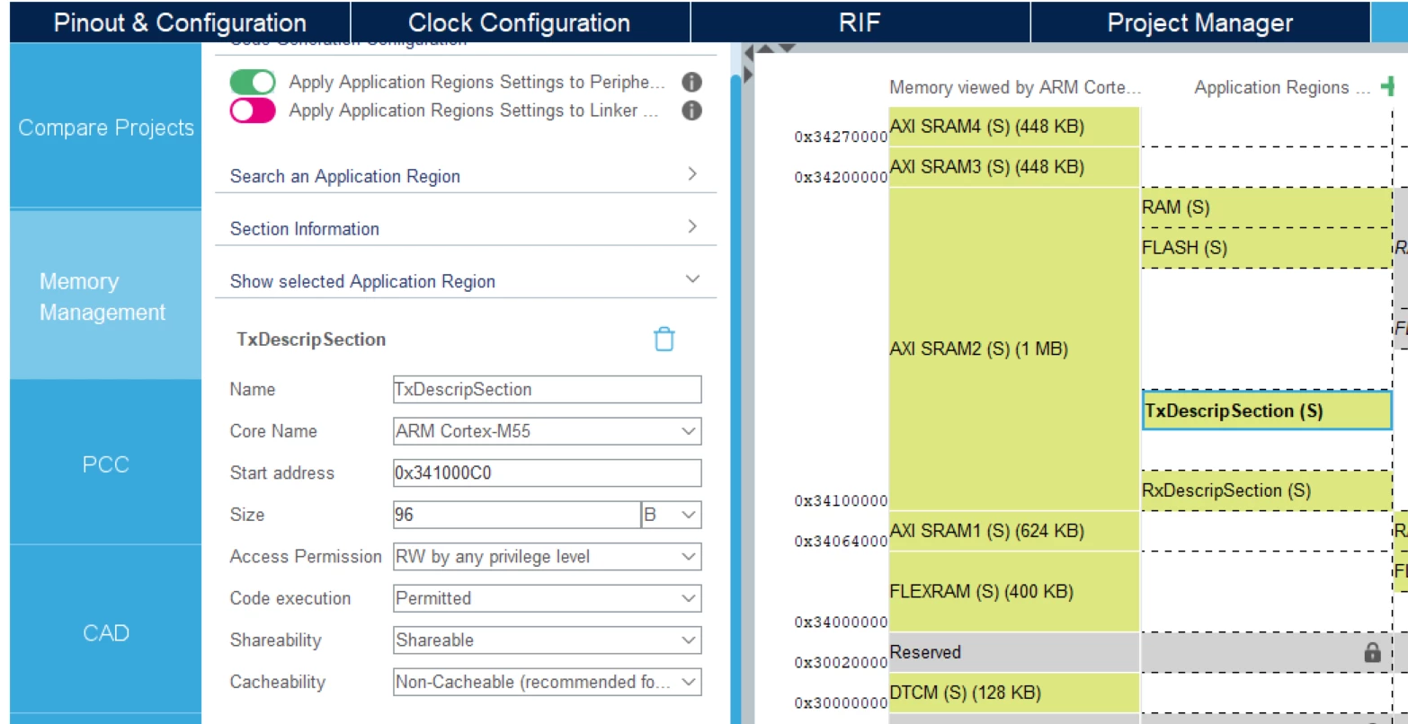

Apr 21, 2026 15:39 UTC
Hello @STackPointer64,
I have made some corrections concerning the attribution of the address for the descriptors, now I can see them in my linker script.
(.RxDescripSection and .TxDescripSection are also defined under SECTIONS)
Nevertheless it came to another issue, I had to double the length of both descriptor, from 96 to 192. I don't understand why the size isn't enough. The size of a section is 96 and the descriptor length is 4.
That are the default values actually. When I set the size to 192 in STM32CUBEMX in the Memory Management it changes te descriptor length to 8.
I gave up for the moment the reception of a raw frame, I am trying now to transmit a raw frame to the pc in polling mode. I am still using this example.
In Debug, I took a look into the DMA registers, and now I still notice in the DMADSR the Suspended Mode for receive Channel 0 and 1  and now for transmit Channel 0 also.
I have THE TBU bit set to 1 in ETH_DMAC0SR, which means that the transmit buffer is unavailable.
ETH_DMAC0CATXBR has a value of 0x0 from the start (buffer address of the transmit descriptor).
Best regards,
