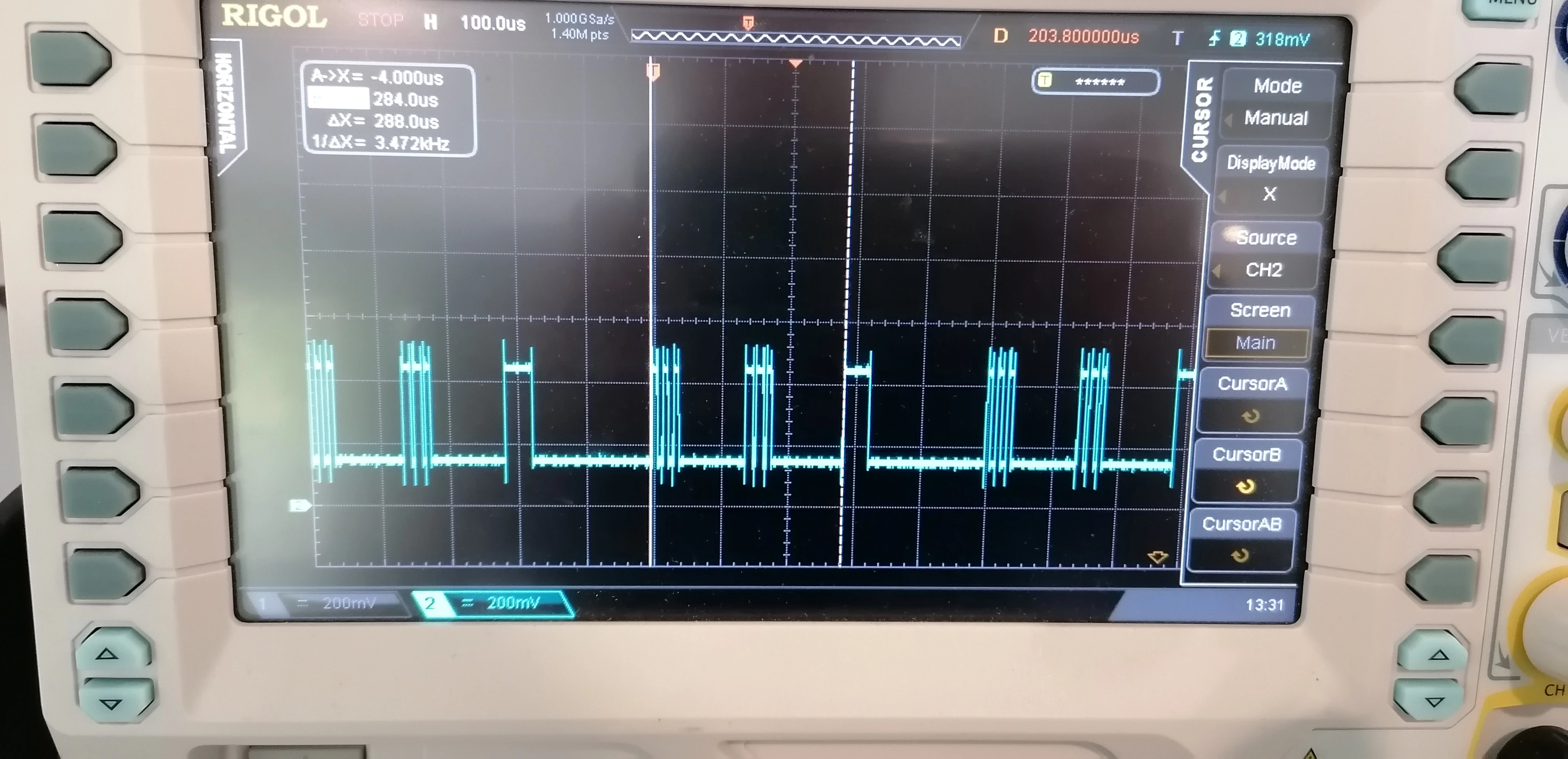

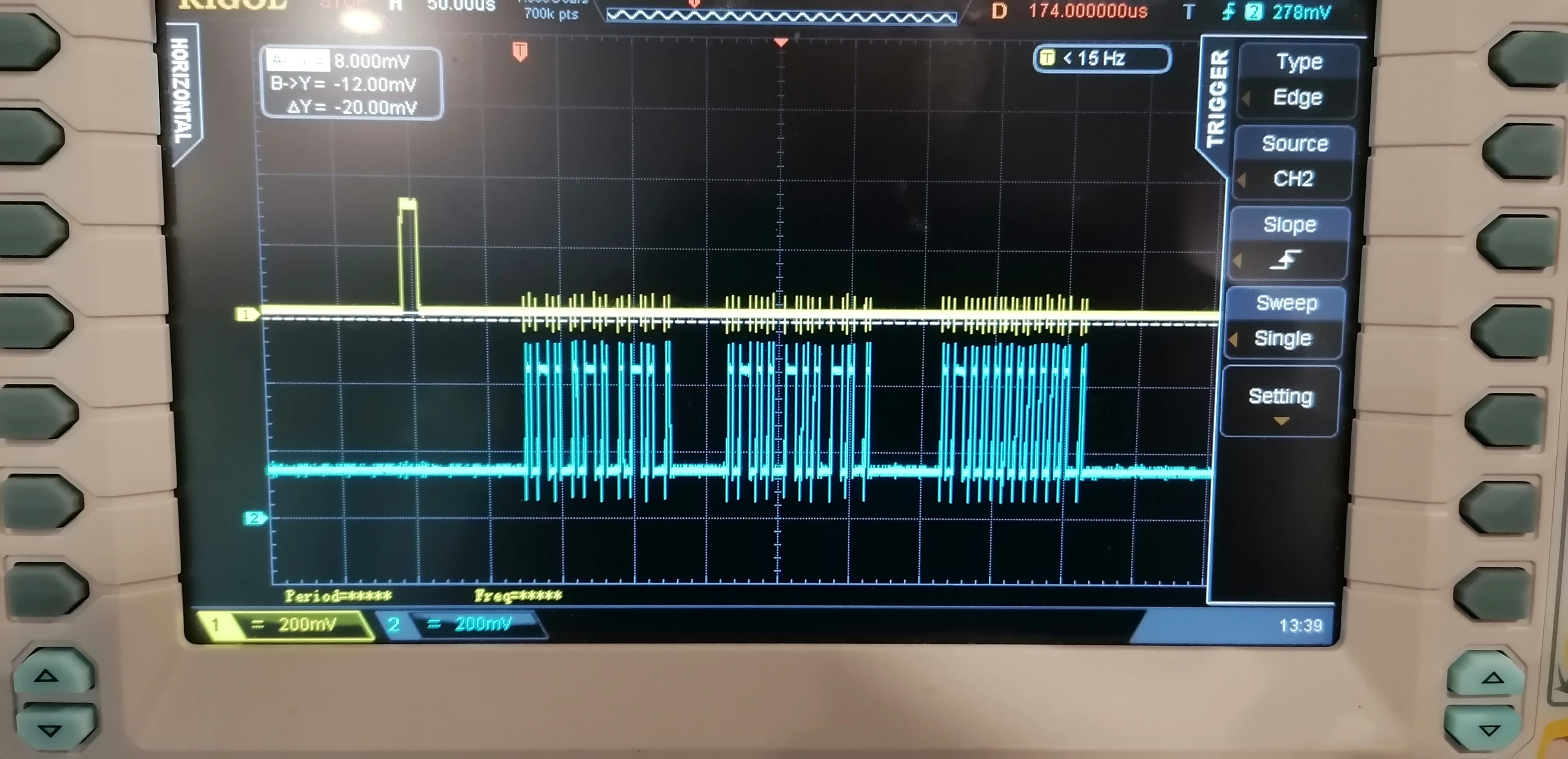

But after the increased clock-frequency, most of my code broke. Timers 3-5 seem to work as expected, but for example Timer 2 is set to ellapse after 800 counts which at 200MHz should equal 4µs, seems to have a duration of 8µs when setting a pin and observing with an oscilloscope. Also lots of steps seem to be skipped, since my generated pattern is missing more than half of it's pulses (the toggling is done when Timer 2 ellapses).

in short what I'm trying to do, is generate a manchester-encoded pattern and drive an output pin with that pattern. That does work, when I use the MCU with 64MHz of CPU clock. I've attached measurements with both configurations and as you can see, it works properly with 64MHz and using the same code, just the different clock configuration, gets all messy when going up to 400MHz (or any other frequency I've tested so far).
I've also attached the code and boiled it down to the functions used for this test. Pattern generation is done using TIM2 & TIM3, where TIM2 switches the bus and TIM3 starts different time slots. The starting points generated by TIM3 are correct, it's just the actual pattern no longer working. TIM5 sends an interrupt every 500µs and one cycle of the pattern. I've also since checked, that TIM2 seems to ellapse every 4µs, so thats working, but switching of the bus gets skipped often so the bus stays in its past state longer.
