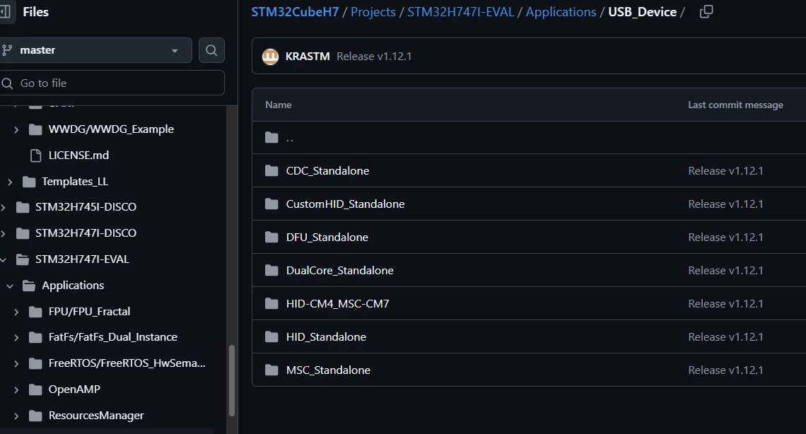

3. I understand your wording as : there is an example of H7 USB Device - USB OTG HS Audio class.
If you share it correctly, it might help.
But I cannot find "Audio_Standalone" example in ./Projects/STM32H747I-EVAL/Applications/USB_Device/ folder.
To me, it seems like under :
Best regards,
From Son.
June 4, 2025
Hi again @skson
Some middleware libraries along with the projects are not available on Github. You can find them directly when downloading from STM32CubeH7.
