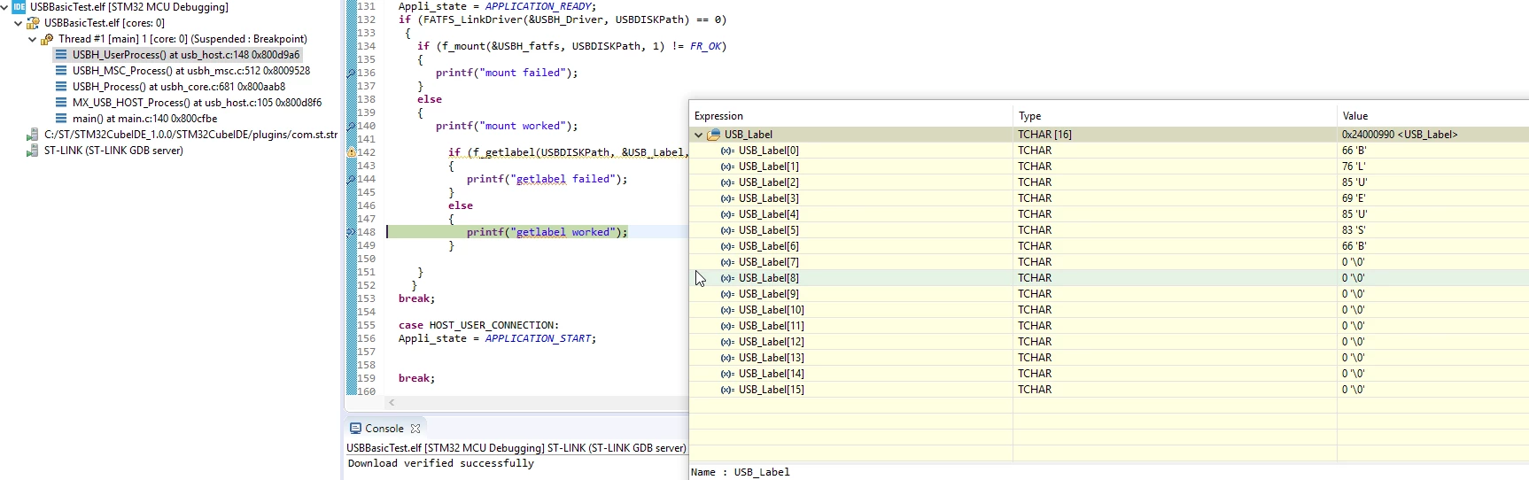

NRobb
NRobbAuthor
Jul 9, 2019 9:25 AM UTC
Hi Peaga,
Thanks for the reply. I am running STM32CubeIDE with CubeMX 5.2.1 and HAL driver 1.5.0.
I added in those callbacks, and it is now working :) I can now mount and read the USB label, and I see it go through the intermediate states as well.
Many thanks for the pointer :)
May I ask if this is something that would be expected to be included in the auto-generated code (as they seem to be adding code to catch the output of it), or have I missed a key section in the application notes somewhere?
Thanks again
Nick
