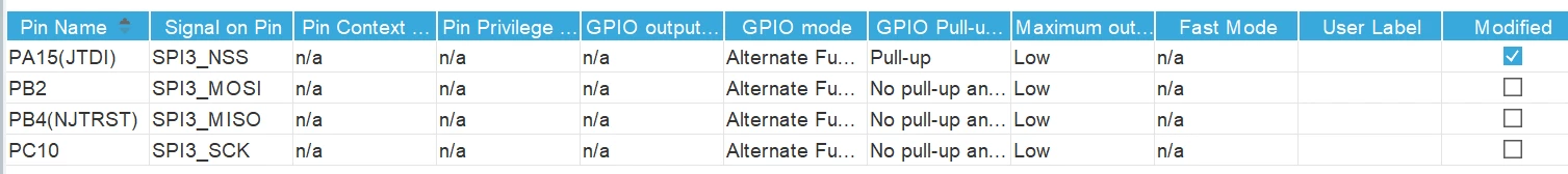

The code uses SPI3 at 20MHz (although the problem occurs at lower speeds as well)
The GPIO pins I’m using are not the defaults:

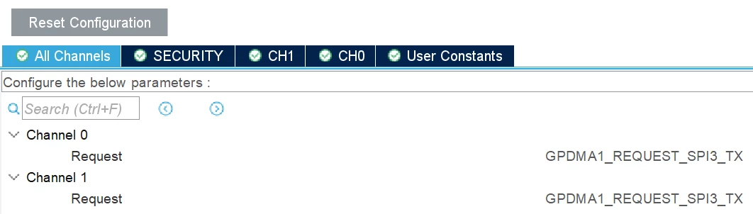

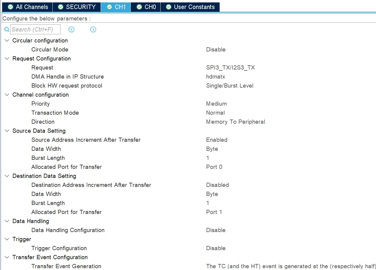

GPDMA1 is configured with two channels for SPI3 TX and RX:

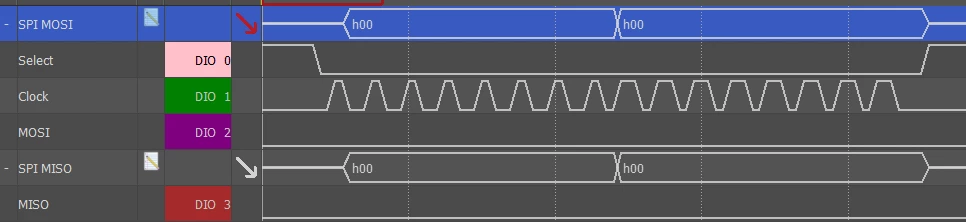

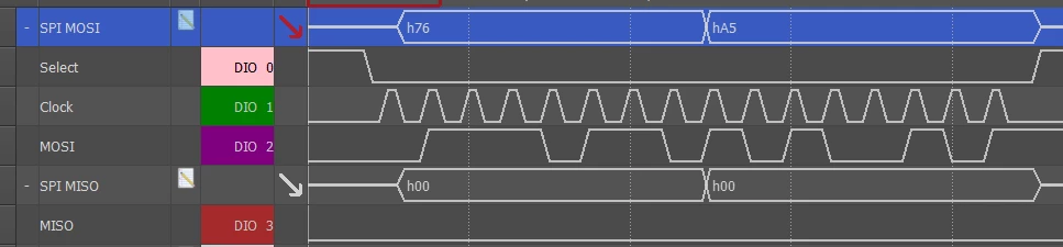

When I have it building for the interrupt APIs, the first transmission looks just like I expect (note that the pulse edges look more sawtooth than square because I’m getting close to the maximum time resolution of my Analog Discovery USB scope, but it still decodes OK):
When I have it building for the DMA APIs, I’m only seeing zero go out:

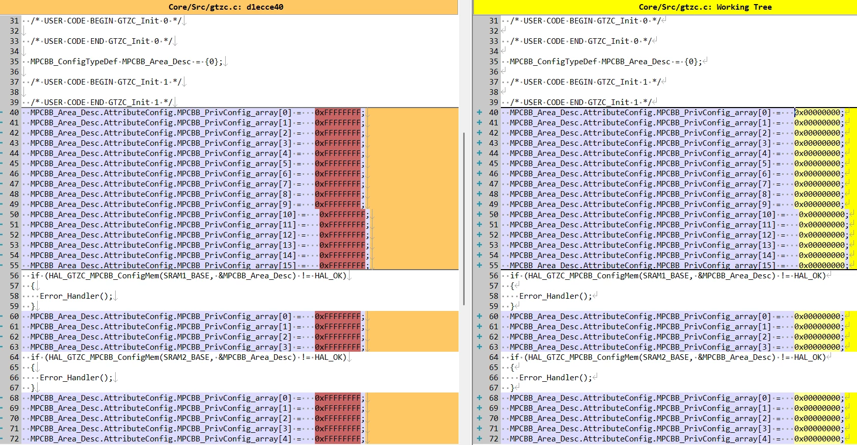

OK, after several answers by people who did not read my original post, or my followup posts or examine the code, and having solved it myself with help from the AI, I am adding a summary of what went wrong in the hopes that if someone else finds this via a search in the future, it will help them solve the problem faster.
  1. I made a project with STM32CubeMX using the template for the Nucleo H563ZI development board, without TrustZone activated. I unchecked “Generate demonstration code” and turned off all the options under “Human Machine Interface.” I set up SPI and DMA as in the project I put on GitHub, linked above. With my application code added, SPI TX and RX via DMA worked fine.
  2. Looking at the FLASH application region, and also RAM application region under Tools/Memory management, RAM defaults to “RW by privileged code only” and flash defaults to “RO by privileged code only.” However, by default, these policies are not enforced because the “apply application regions settings to peripherals” is off and the generated startup code does not limit access to SRAM by the DMA or set flash option bytes. So the DMA, which is “unprivileged,” will read and write to SRAM and read from flash just fine.
  3. Much later I wanted to change the memory map and flash configuration so I could write code to use the last page of user flash for saving calibration data. To do this I shrank the default FLASH application region to 2040KiB from 2048KiB, and set up an application region, “FLASH_APP_DATA_AREA,” one 8KiB flash block at 0x081FE000 (the last page of user flash). I set this flash region so it had access permissions “RW by any privilege level,” code execution “Not Permitted,” Shareability “Non-Shareable,”  and Cacheability “Non-Cacheable” (which I had learned was critical for letting my code write to flash without crashing). I turned on “Apply Application Regions Settings to Peripherals” and “Apply Application Regions Settings to Linker Files.”
  4. After this change, STM32CubeMX now generates MX_GTZC_Init() in main which sets all the privilege bits to 1. This now enforces the privilege protection of SRAM and my SPI reads using DMA cannot transfer data from the SPI bus to RAM (my read buffers remain zero). It also generates MX_FLASH_Init() which sets the volatile block-based protection bits for all regular flash (except the last page). So, my SPI writes using DMA cannot transfer data from my flash data structures to the peripheral (only zeroes are sent on MOSI).
  5. Note that even without adding a special application region for that last page in flash, just turning on the “Apply Application Regions Settings to Peripherals” box will result in the generation of MX_GTZC_Init() and MX_Flash_Init() which effectively now locks the DMA out of being able to access flash _or_ SRAM. This is the unexpected behavior that wound up costing me days of work trying to figure out what was suddenly going wrong and why. It was especially frustrating given that I had not changed the SPI or DMA settings in STM32CubeMX at all, but it appeared that SPI and/or DMA was now broken so that is where I was focusing my debugging efforts at first.
  6. This may not technically be a bug in STM32CubeMX - maybe it is intentional behavior - but it seems strange that the defaults for SRAM and flash are so restrictive that they break DMA access to either, and also that those defaults are not _applied_ by default. If the defaults had not been so restrictive, I would not have run into this problem. If the code had been generated to enforce those defaults, by default, I would have run into this problem when I first tried to use DMA and presumably solved it then. Instead it was sort of a “ticking time bomb” that didn’t cause me any issues until I turned on code generation for the application regions. I was trying to enable write access to one page of flash, and wound up accidentally making it so the DMA engines couldn’t access any flash or SRAM.
  7. So, I would request that ST Micro take a look at this behavior and consider changing it to be more programmer-friendly. There may be a point to locking out DMA access if you are working on some very critical locked-down code, but I don’t think that should be the default, especially since I didn’t even turn on the “TrustZone” features.
Thanks for reading and, like I said, I hope this helps keep someone else from wasting a lot of time trying to solve this like I did.

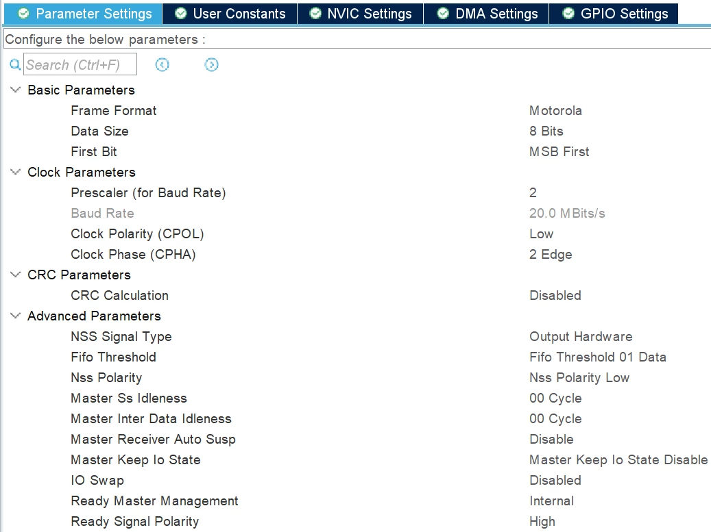

  • set in Cube , SPI → master keep io state : enable (to keep the lines active)

  • the DMA can be tricky/complex on H563 , so what you use: linked list or not ?
  • where you start DMA ?

Aug 8, 2026 14:58 UTC
Hi AScha.3,
Thanks for your reply.
The pin speed is a good idea - I had them set to medium in an earlier project but forgot to change it in this .ioc file. It doesn’t fix this problem but it should improve reliability.
The “Master Keep Io State” setting: I have never seen that setting mentioned in any examples or documentation. I tried setting it to “Master Keep Io State Enable” but that change didn’t make any difference.

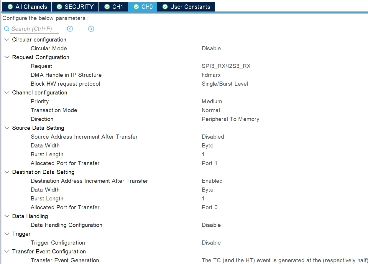

My DMA settings are as shown: for channel 0 (RX):
For channel 1 (TX):
My peripheral initialization is not modified from the code generated by STM32CubeMX in spi.c. See:
https://github.com/paulrpotts/nucleo-h563zi-adc-MCP3564R/blob/trunk/Core/Src/spi.c
I’m not using a linked list or circular mode.

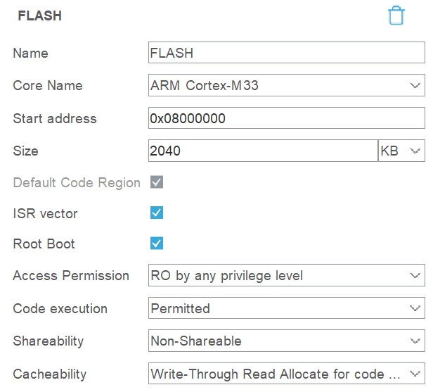

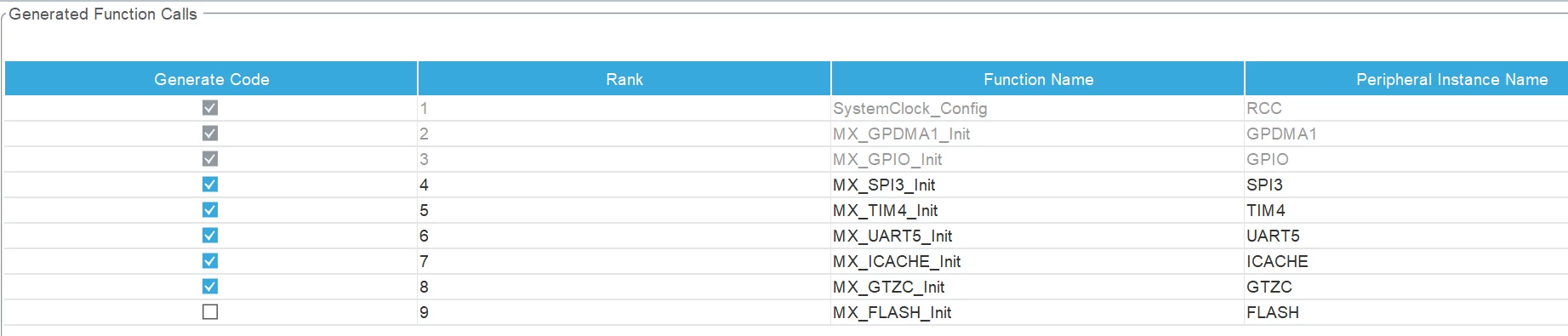

It appears I have a clue. It looks like initializing the flash peripheral at startup, but never explicitly using it, is interfering with the correct functioning of the DMA.

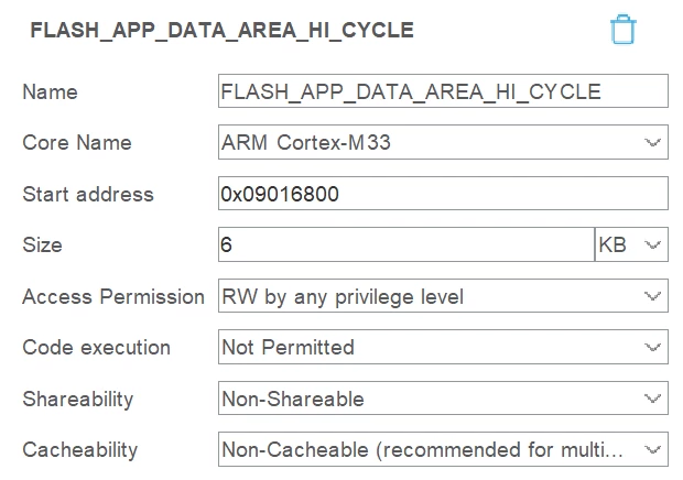

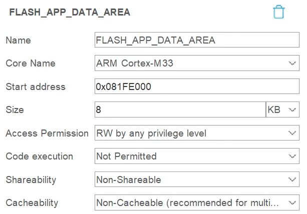

My .ioc file defines special memory areas to allow my code to access the highest/last page of user flash either through the regular user flash addresses or through the high cycle data area addresses:
and
This results in the flash peripheral enabled:
And also the creation of MPU_Config() in main.c, and calling it at the very start of main(), although this specifically does not seem to be the cause.
If I turn off this setting:
Then I can turn off the Enable checkbox under FLASH.
Cube MX then no longer generates flash.c and flash.h and no longer calls MX_Flash_Init() from main(). The MPU_Config() is not changed and is still called at the start of main(). But without the call to MX_Flash_Init() at startup, the SPI DMA transmit works correctly.
So, it appears that initializing the flash peripheral is interfering with the correct functioning of the DMA, even though the code in this project is not actually using those flash pages. So I will have to figure out what the conflict is. My full application uses that flash page to store calibration data so I can’t just disable it completely.
It doesn’t seem to be caused by the MMU configuration, since that is still being generated in main.c and that did not change.

OK, with the assistance of the STM32 “Sidekick” AI, I have worked out that I needed to set the access permission for the Application Region “FLASH” to “RO by any privilege level.” If it isn’t set this way, the generated MX_FLASH_Init() sets the FLASH_BB_PRIV bits to 1 except for the separate Application Region I defined as the last page of flash. Then when the DMA attempts to read const data that the compiler put into flash, it gets a privilege violation and reads only zero bits.
Changing this results in the generated MX_FLASH_Init() function containing _only_ Flash_Unlock() and Flash_Lock(), which pointless, so I turned off generation of MX_FLASH_Init() under Project Manager/Advanced Settings, since it is not needed.
I will leave this here since this solution did not seem obvious - Google AI in particular never came up with any suggestions having to do with the access permissions coming from FLASH_BB_PRIV bits interfering with the DMA’s ability to read from flash, but not the CPU’s. Some kind of option on the DMA configuration pages, to enable reading from flash, might also have been useful.

And there’s a similar issue in SRAM that is fixed in a similar way. All this came about behind the scenes because I wanted my code to be able to write to a single page of flash.
