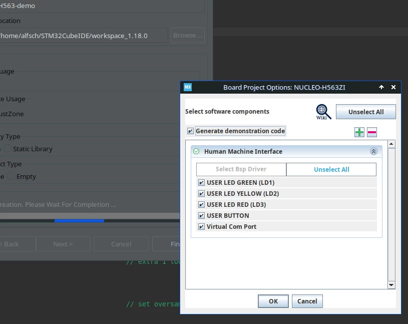

dimax
dimaxAuthor
November 24, 2025
Thanks.
I can definitely see all related projects for NUCLEO-H563ZI, but it is not
clear which specific one was initially programmed on EVB.
Currently it blinks 3 leds one by one and I do not see the corresponding
project in Cube FW.
AScha.3
November 24, 2025

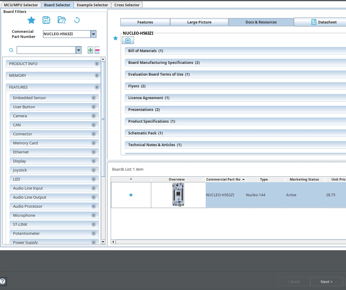

Try : new project..: select NUCLEO-H563ZI board
+ give it a name ...H563-demo ...or so, then :
check: generate demo..
...then try compile , debug...
