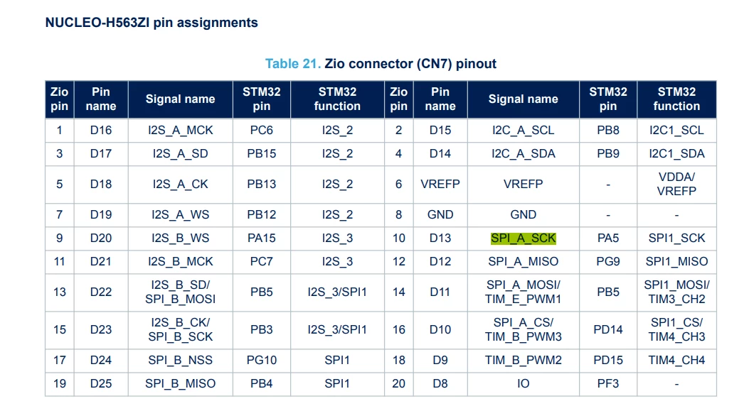

1) In the manual for the NUCLEO eval board it says,
SPI_A_SCK (PA5) is CN7 pin 10.
The readme.md under the project says
CN6 pin 10
I assume one of them is a typo?
Yes, as for all STM32H5 Nucleo-144 boards, there is CN7, CN8, CN9 and CN10, so in the Readme it should be:
CLK Pin : PA5 (pin 10 on CN7 connector) instead of CN6
