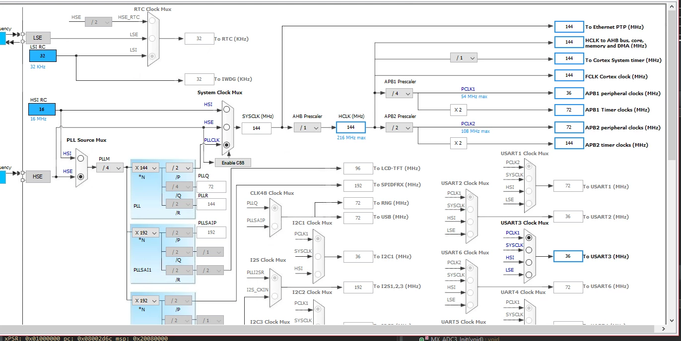

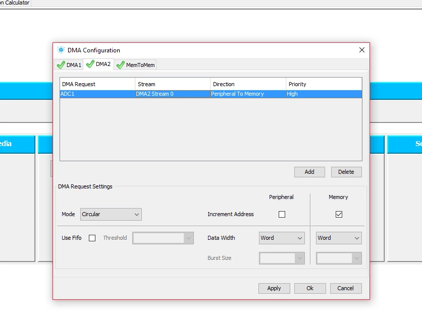

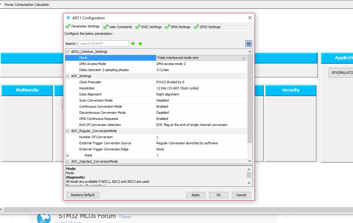

Hi folks,
I'm stuck trying to run ADC Triple interleaved mode. When I try to run at 7.2MSPS, it never executes the while(1) loop in main function. When I use the Clock Prescaler as PCLK2 divided by 6 (resulting 12MHz ADC Clock), the results are printed on UART but it shows wrong values (like 268374015 in 3.3V). I've tried to get my inspiration at the STM32F7 examples that have Triple Interleaved Mode. What am I doing wrong?

And these are the screenshots of the CubeMX (latest version) configs:
0690X0000060MCaQAM.png0690X0000060MCfQAM.png0690X0000060MCkQAM.png0690X0000060MCpQAM.png

I'd expect the samples to be packed as 16-bit values, not 32-bit ones, you'll want to read as 16-bit words or take the 32-bit word and split into two samples.
Helder Sales
July 15, 2018
Posted on July 15, 2018 at 06:57
That's it! I thought the three ADCs were triggering with some phase delay, but it seems that according to some text file I've found (thanks to your reply),
1st request: ADC_CDR[31:0] = (ADC2_DR[15:0] << 16) | ADC1_DR[15:0] (step1)
2nd request: ADC_CDR[31:0] = (ADC1_DR[15:0] << 16) | ADC3_DR[15:0] (step2)
3rd request: ADC_CDR[31:0] = (ADC3_DR[15:0] << 16) | ADC2_DR[15:0] (step3)
Now things are more clear! Thank you! (got the values by splitting into g_val[0] >> 16 and g_val[0] & 0xFFFF)
Now I've only one problem left, setting ADC sample rate higher than 2.4MSPS makes the code 'hang' after HAL_ADCEx_MultiModeStart_DMA call. I've examined with the debugger and the ADC variables are updating, but the program never reaches while(1) loop, it just stucks right after the ADC start call. I don't believe 2.4MSPS is extremely high to cause that...
EDIT: Actually, it does look like the CPU is trying to reach while loop but never reaches because of interrupts, and when I disabled the I/D Caches (or triggered the ADC by timer) the situation worsened.
