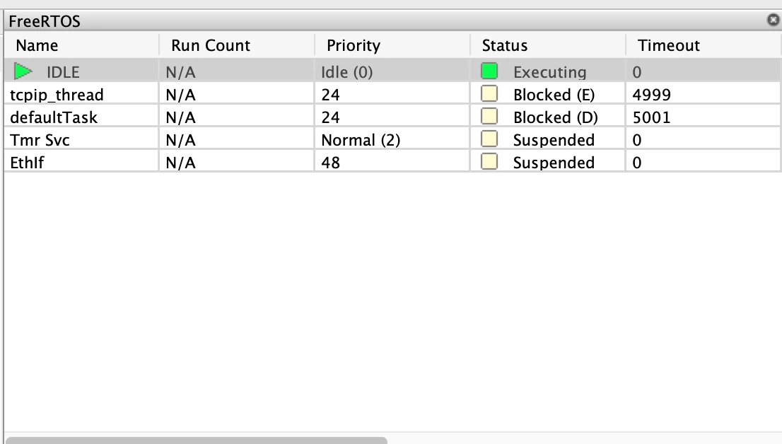

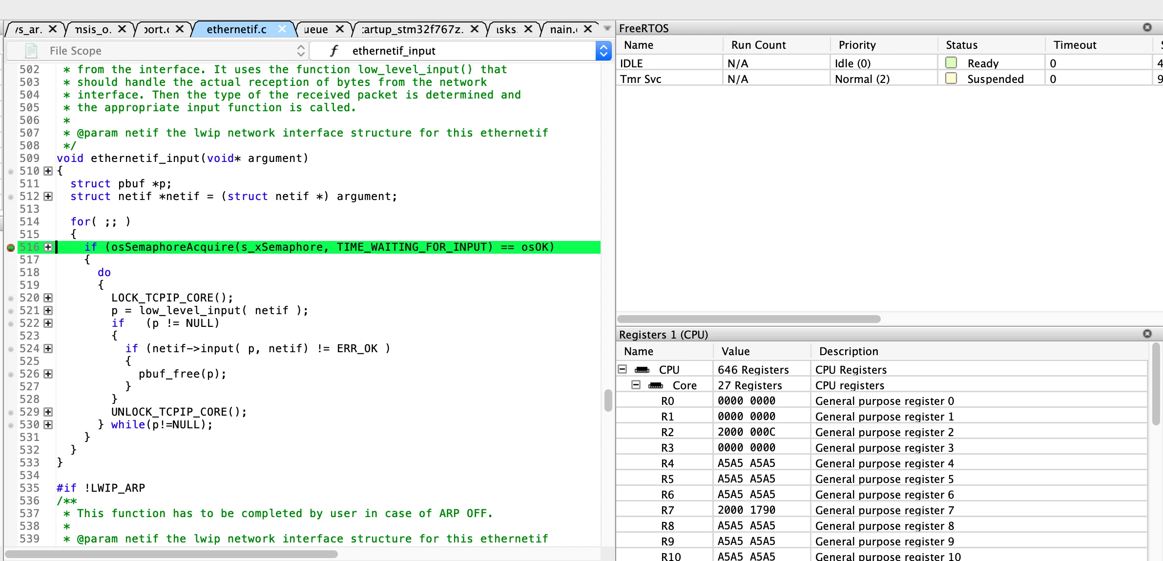

0693W000003Pob4QAC.png0693W000003PoaGQAS.pngI started debugging now with Ozone. My Led task is not visible anymore after the device crashes, and the mcu seems to cycle in this function:
void ethernetif_input(void* argument)
 struct pbuf *p;
 struct netif *netif = (struct netif *) argument;
 for( ;; )
 if (osSemaphoreAcquire(s_xSemaphore, TIME_WAITING_FOR_INPUT) == osOK)
 do
 LOCK_TCPIP_CORE();
 p = low_level_input( netif );
 if (p != NULL)
 if (netif->input( p, netif) != ERR_OK )
 pbuf_free(p);
 UNLOCK_TCPIP_CORE();
 } while(p!=NULL);
it stays within the for( ;; ) . The only tasks left in the taskview are idle and tmr svc.
