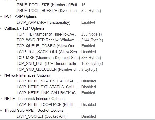

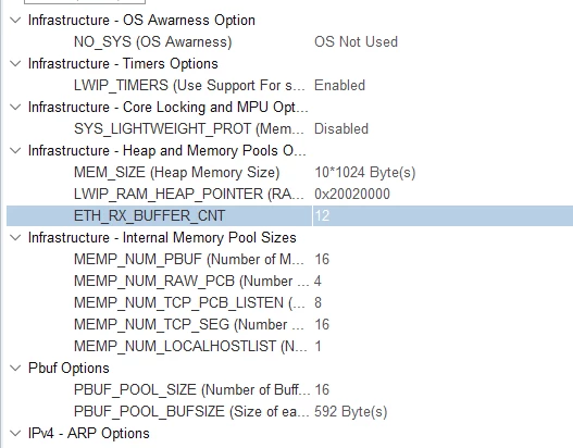

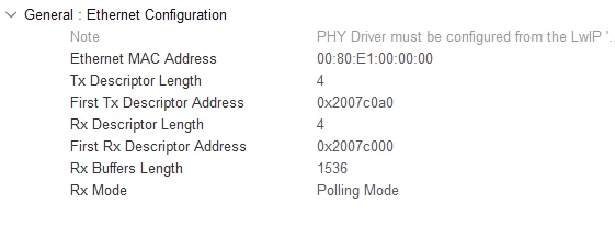

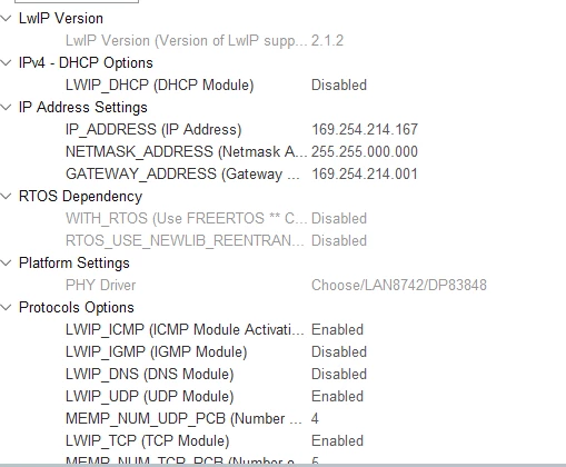

Hi, I am trying to develop ethernet project on stm32f767zi. I am facing the problem when I am trying to pinging from PC to stm32. "Destination host unreachable." How can I fix this? I read similar topic but anything couldn't solve the problem. I shared the configurations and main code with you. I am waiting for the answers. They will really help me I believe.
Have a nice day.
emirhan37_0-1739873809824.pngemirhan37_1-1739873993787.pngemirhan37_2-1739874001125.pngemirhan37_3-1739874020809.pngemirhan37_4-1739874029569.png

Hello @emirhan37 ,
Could you try this example I have shared you will need to change the IP address accordingly in lwip.c file.

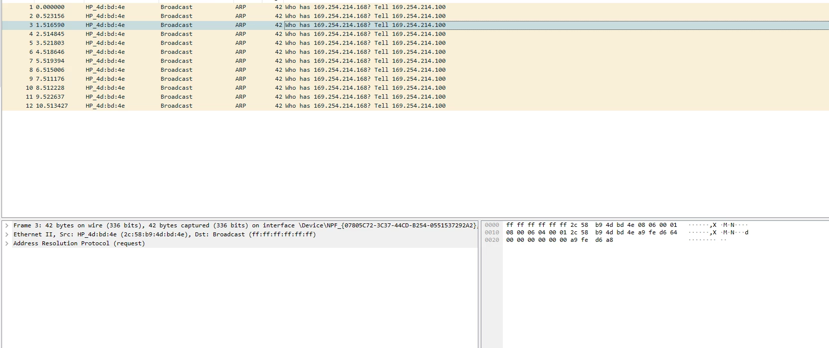

emirhan37Author
Feb 18, 2025 11:54 AM UTC
This is the log when I try to ping from pc to stm32.
I tried to ping from pc to raspberry pi with same cable and same target ip and it was successfully done. I need to see ping communication between pc and stm32f767zi over ethernet.

emirhan37Author
Feb 18, 2025 12:56 PM UTC
Hi, You project is worked! Thank you so much. Can you describe the changes or differences with my code. What is the problem in my configurations?
Feb 18, 2025 1:22 PM UTC
Hello @emirhan37 ,
I didn't go throw you configuration enough, so I recommend you compare the two projects to see the difference with a tool like winmerge.
