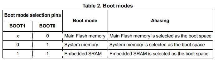

Hi @Community member​ ,
Thank you for your contribution.
The Schematic Pack is in line with the boot modes table described in the reference manual RM0090 and precisely in section 2.4.
0693W00000UnF3NQAV.pngWhen your question is answered, please close this topic by choosing Select as Best. This will help other users find that answer faster.
Kaouthar

Your comment doesn't answer anything related to the actual issue. The real question is why the BOOT1 on a Nucleo board is floating by default.
KDJEM.1
Oct 4, 2022 8:15 AM UTC
My understanding is that BOOT1 was kept floating in Nucleo-F429Zi in order to allow the user to select suitable boot memory (setting the solder bridge) depending on his needs:
  • If the system memory is selected as the boot so, the BOOT1=0 and BOOT0=1.
  • If the embedded SRAM is selected as the boot so, the BOOT1=1 and BOOT0=1.
Thanks,
Kaouthar
Piranha
Principal III
Oct 5, 2022 3:13 PM UTC
A pull-up/down still allows the user to force the pin to the opposite level. If the BOOT1 would be pulled down through R73 100k by a closed SB152, then, when the user sets BOOT0=1, by default the MCU would boot the System bootloader, which is necessary more often that booting SRAM. But now it's unpredictable. And adding a 100k pull-down on one of the pins will rarely interfere with other usage of that pin even without disconnecting that pull-down.

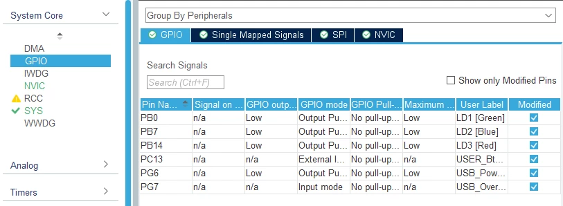

I wonder whether you do use PB2 and set it high in your application - that's my only explanation for the symptoms you've described (bootloader not entered upon pushbutton reset).

No, I don't use PB2 in my application.
0693W00000UnJH4QAN.pngIt is just a simple LED blink application for me to use when testing the bootloader.
