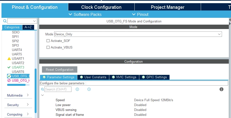

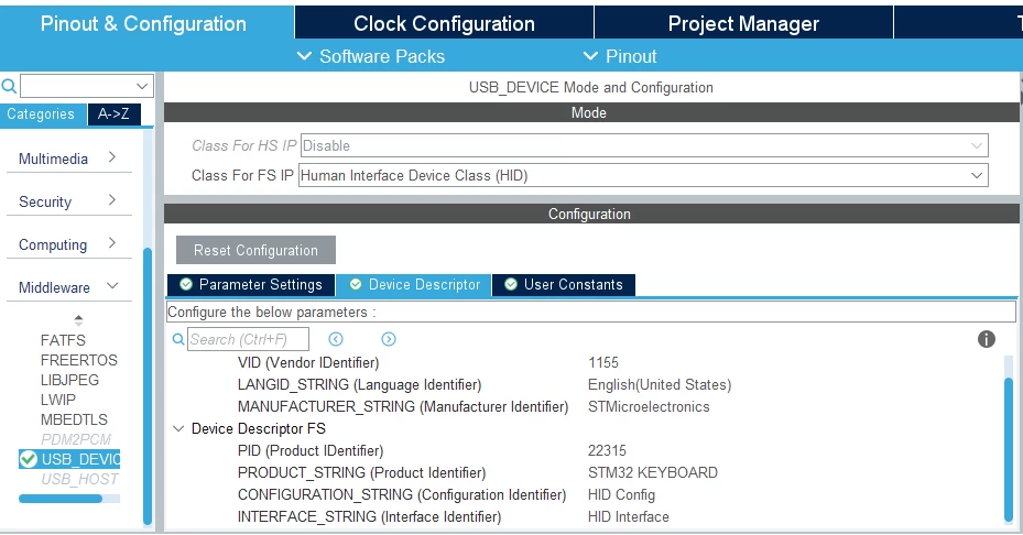

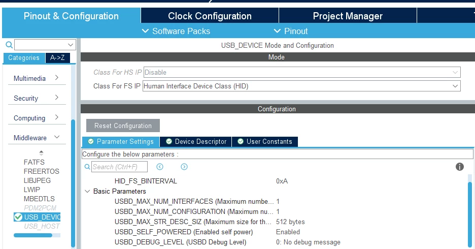

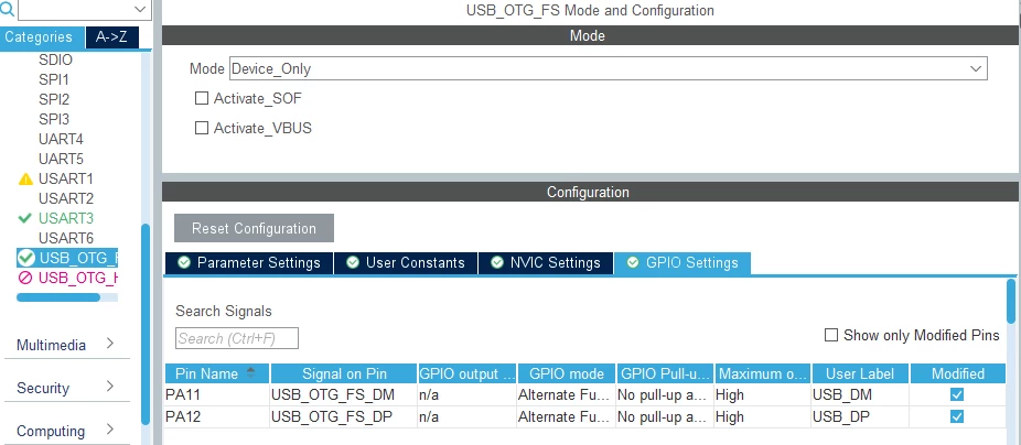

I am using Nucleo-F207ZG development board and trying to make it as keyboard type device.
I have changed 0x01 in 'USBD_HID_CfgFSDesc'
And also changed 'HID_MOUSE_ReportDesc' for keyboard.
I have attached screen shot of .ioc fie settings, please guide me.
