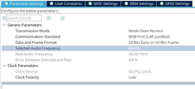

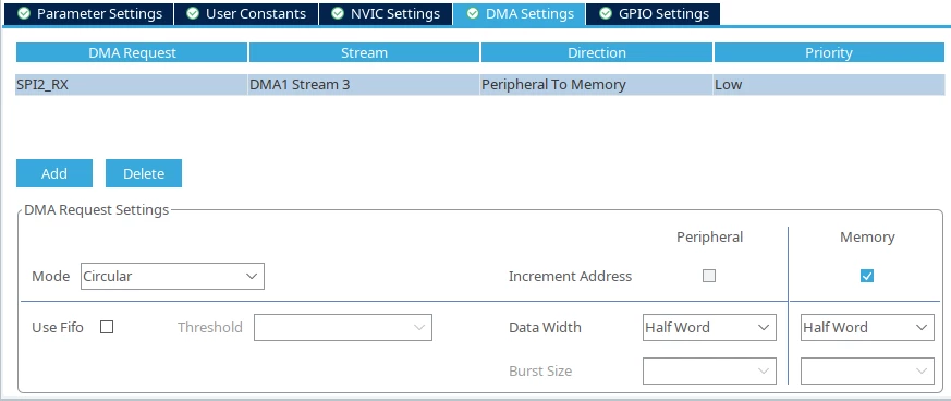

The driver instructions don't mention that some configuration is needed in CubeMX, although the I2S2_init function unhelpfully says, "This function assumes that the I2S input clock (through PLL_R in Devices RevA/Z and throughd edicated PLLI2S_R in Devices RevB/Y) is already configured and ready to be used."
I copied the settings seen in this instructional video. That didn't work, but it did at least cause the callback functions to start being called... once each, then never again, with the hi2s2 state staying as HAL_I2S_STATE_READY.

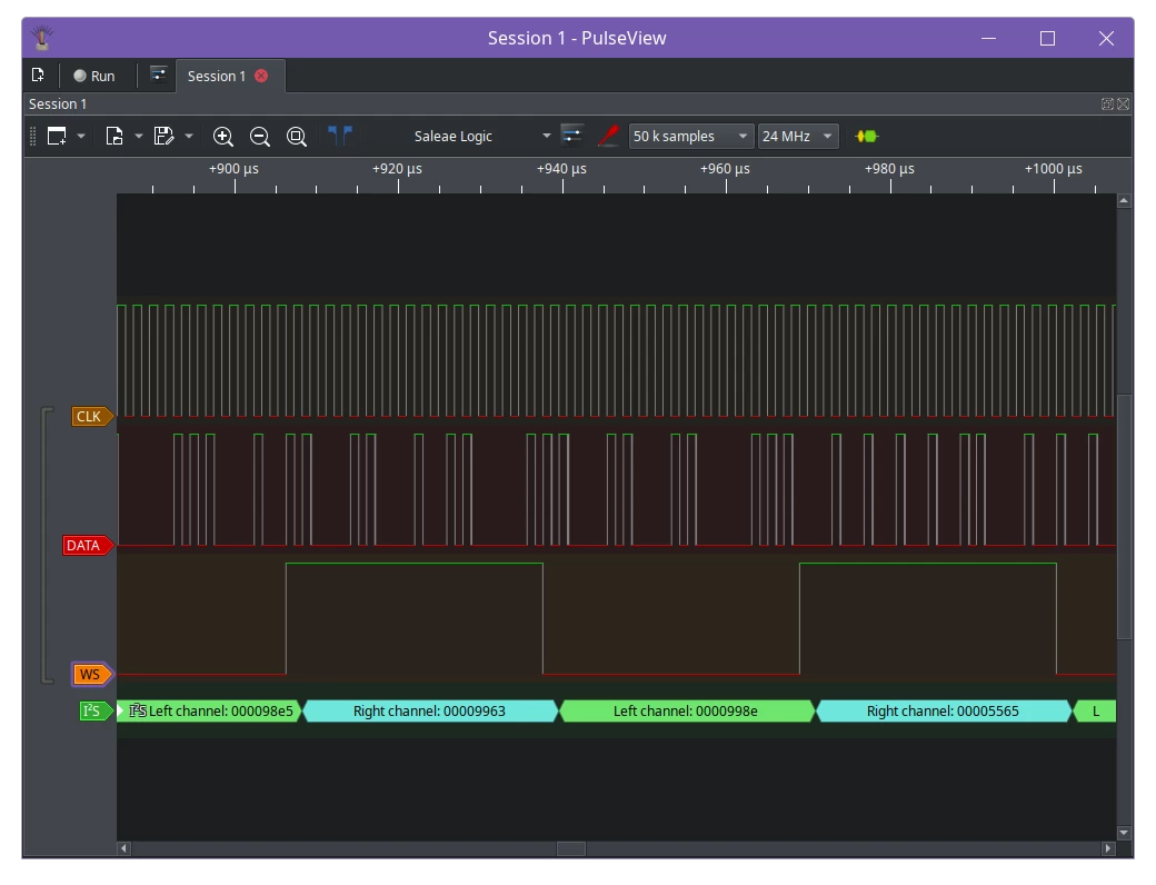

I got a cheap logic analyzer and looked at what was going on:
Could this be anything but hardware damage? There is near silence in the room, so the MEMS microphone should be transmitting zeros as its PDM signal, right? If so, this is the second board which I've seen behave this way. Is there some novice mistake I'm making which could be damaging them?
