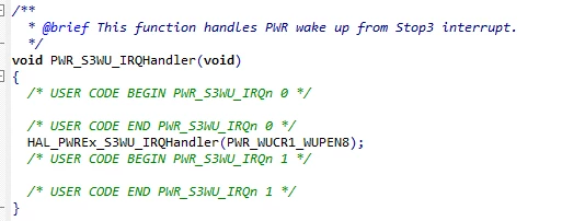

Hello @mohan-ltts,
Using this ST example STM32CubeU5/Projects/NUCLEO-U575ZI-Q/Examples/PWR/PWR_LPMODE_RTC at main · STMicroelectronics/STM32CubeU5 with your configuration does not cause the issue you mentioned. It works fine without the need for a reset.
As mentioned by @Imen.D, please redefine the PWR_S3WU_IRQHandler to wake up the system as shown below.

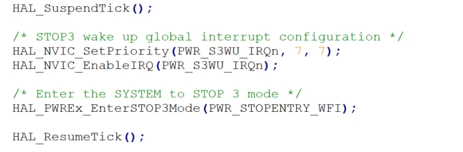

December 27, 2024
Please ensure that you suspend the SysTick interrupt before entering STOP mode as shown below:
With Regards,
"If your question is answered, please close this topic by clicking ""Accept as Solution""."

January 20, 2025
Hello everyone,
I’ve moved the last comment of @mohan-ltts which wasn’t directly related to the initial post (Separate thread link: Issue to wake up from stop 3 mode when migrating fr... - STMicroelectronics Community
However, to conclude this discussion, the issue is resolved when suspending SysTick before entering stop 3 mode.
