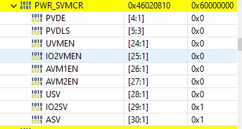

Do you have the analog voltage domain isolation removed, i.e. PWR_SVMCR.ASV set?
Feb 18, 2025 11:07 AM UTC
yes PWR_SVMCR.ASV set

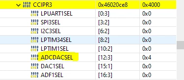

ADC clock enabled and running?
Read out and check/post ADC registers content.
Feb 19, 2025 1:13 PM UTC
ADC clock enabled.
