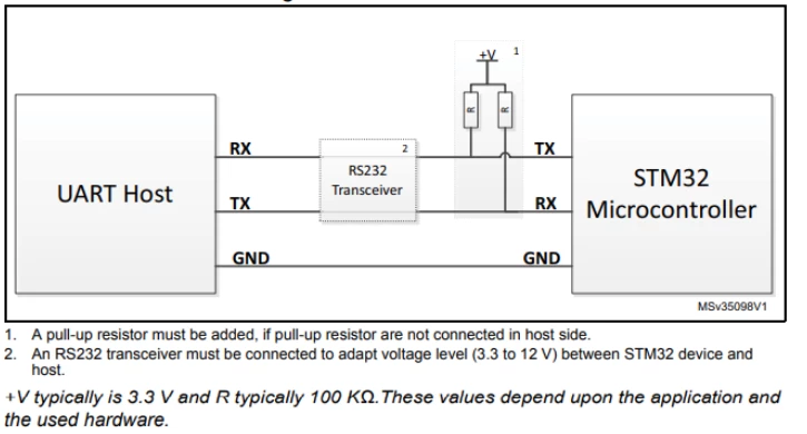

3) Using the FTDI module, connect the BOOT0 pin to DTR and the NRST pin to RTS. Signalling using FTDI module itself.
4) Added the additional pull ups in UART Tx,Rx as suggested in the data sheet
Please let me know what went wrong with the signalling portion. Your assistance and backing are much appreciated.

@MM..1​  We have used USART2 Rx and Tx in STM32G030F6P6.

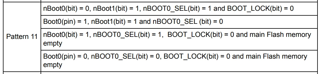

We have used PA2 and PA3 and followed the signalling sequence to do pattern 11
a) NRST pin set to LOW and BOOT0 pin to HIGH to select System memory
b) NRST pin set to HIGH to boot into bootloader
Is the above mentioned sequence correct? Please let me know if there is anything wrong with the sequence/pattern

As already answer by @MM..1​, the STM32G030 bootloader is configurated by pattern 11.
I advise you, when you configured the bootloader, to refer at this AN2606 "STM32 microcontroller system memory boot mode" and get inspired form the steps described in this MOOC "STM32 boot and startup tips - 2 Embedded bootloader investigations".
