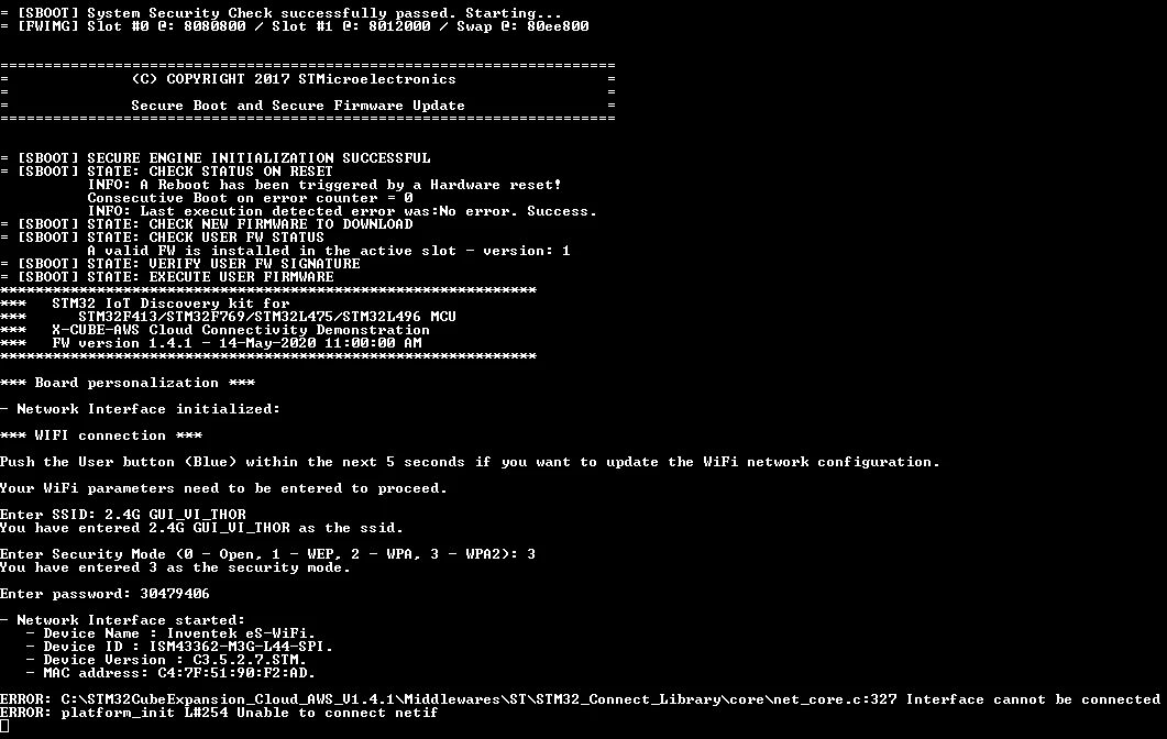

I'm trying to run the Getting Started firmware for the B-L475E-IOT01A board but I'm having problems to connect to WiFi. The error messages are:
"ERROR: C:\STM32CubeExpansion_Cloud_AWS_V1.4.1\Middlewares\ST\STM32_Connect_Library\core\net_core.c:327 Interface cannot be connected
ERROR: platform_init L#254 Unable to connect netif"

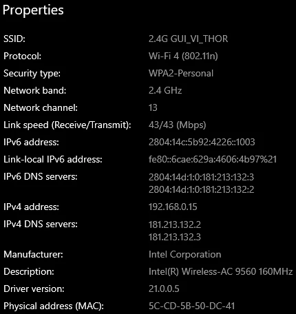

These are my WiFi Properties:

  1. I'm using the following Getting Started firmware: STM32CubeExpansion_Cloud_AWS_V1.4.1\Projects\B-L475E-IOT01A\Applications\Cloud\AWS\Binary\SBSFU_B-L475E-IOT01_Cloud_AWS_V1.4.1.bin
  2. The target board is the B-L475E-IOT01A2
Am I missing something?
Thanks in advance,
Guilherme Amorim.

  • are you using an iPhone as WiFi/4G gateway to connect the B-L475E-IOT01 to WiFi ? with a recent version of iOS ? it may require WPA3 which B-L475E-IOT01 WiFi module doesn't support.
  • other possibility (maybe): try to configure the SSID name of your WiFi access point without a space character in the SSID name

Hi @Guillaume K​ and @Imen DAHMEN​ ,
I'm now able to connect to the WiFi access point. It seems that the WiFi should be configured with access point and I was not aware of that.
Thanks a lot,
Guilherme Amorim.
