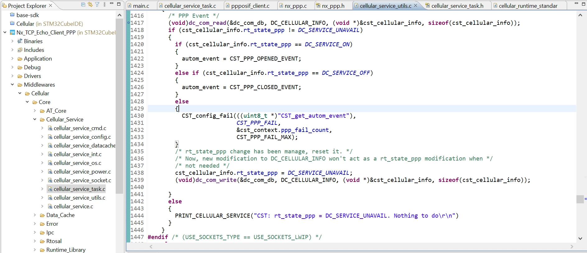

Not able to bring PPP connection using X-Cube-Cellular Nx_TCP_Echo_Client_PPP example.
Application is restarting after MODEM_PDN_ACTIVATING_STATE - PDP_ACTIVATED_EVENT
the IP stack running STM32-side with LwIP.

CST: New State: CST_PPP_CONFIG_ON_GOING_STATE
CST: rt_state_ppp = DC_SERVICE_UNAVAIL. Nothing to do
CST: autom_event = no event
//Application is restarting here.

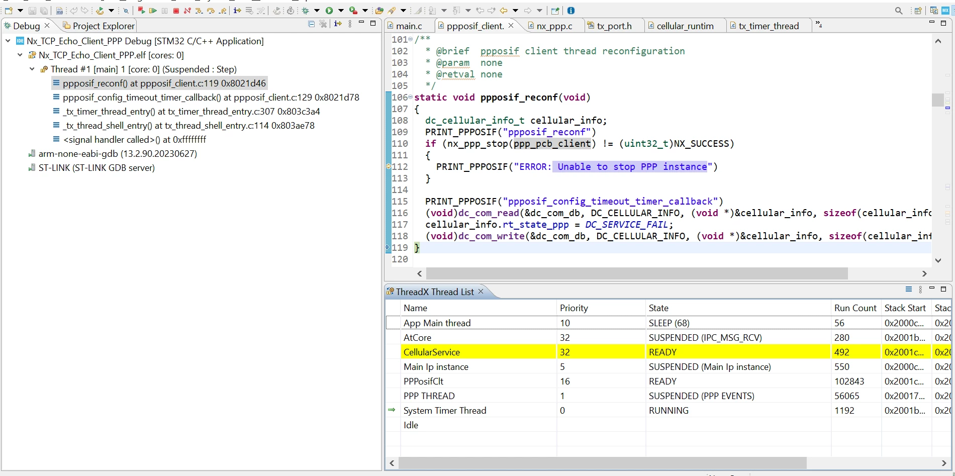

I have observed that it's failing here and then issuing the MODEM_REBOOT_STATE.
CST: AUTOM TASK: MODEM_REBOOT_STATE - MODEM_REBOOT_EVENT

This looks like some communication issue between the STM32 and modem - not getting the expected response
Together with this error: "ATCore ERROR:DATA ongoing, can not send a command"
