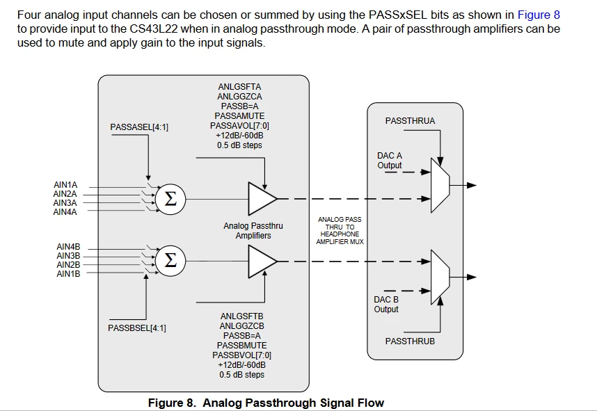

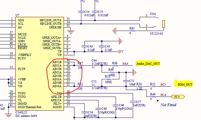

I'm using STM32f4-Discovery board for an audio application.
I'm using the onboard codec CS43L22, in analog passthrough mode. But I'm getting high frequency noise on the output over headphones.
Can anyone tell what could be the possible reason for this noise and what might be the solution?

Posted on September 15, 2017 at 11:06
Hi.
You mean you have noise without some input signal ?
Is the correct AnalogIN  input selected?
If for example you have selected the input from PDM_OUT, you hear the digital ''noise'' of microphone.
If you have selected the input from DAC_OUT...Make a test , configure the DAC_OUT   PA4 as GPIO  PP output in low state.  Observe for noise. If noise exists the CS43L22 is not correctly intialized or has some HW malfunction.

I'm taking input from an external analog mic. The flow is Mic -> ADC -> DAC -> Codec
-In the above flow, even if I don't give any input to ADC, there is some noise. (Some frequency components-4kHz, 4.5kHz, 16kHz).
-Yes. I'm using AIN1A, AIN1B.
Selected input is DAC_OUT.

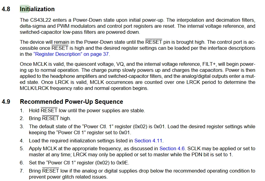

Vangelis Fortounas
September 15, 2017
Posted on September 15, 2017 at 12:36
Hello again.
I can't help you  by giving you the correct sequence of register values must put in CS43L22( i don't have time to study the registers)
But in general  (with some study also)
Initialize I2C port to communicate with cs43l22  (PB9, PB6)
initialize PD4 pin as reset pin to cs43l22 (GPIO PP output)
Apply the reset sequence (by the  datasheet) after power on.
and  ...  begin to send via I2C, the commands to initialize the cs43l22.
