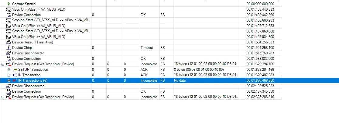

No Status Out transaction for USB on STM32F070F6
  • July 24, 2019
  • 0 replies
  • 724 views
I have coded some usb code which is correctly sending and recieving data. The problem is that at the end of sending the device descriptor no STATUS_OUT packet is sent.
I've done the following to get the above sending:
  1. Copy the rx data from usb buffer (Packet Memory Area).
  2. Determine the recieved request is a Device request.
  3. Clear the CTR_RX flag.
  4. Write device descriptor to transmit section of usb buffer (PMA).
  5. Set STAT_TX to valid (by toggling with an XOR).
If I just to the above, this happens:
The above STAT_TX/IN transaction should result in a CTR_TX type CTR interrupt. Inside that handler I do the following:

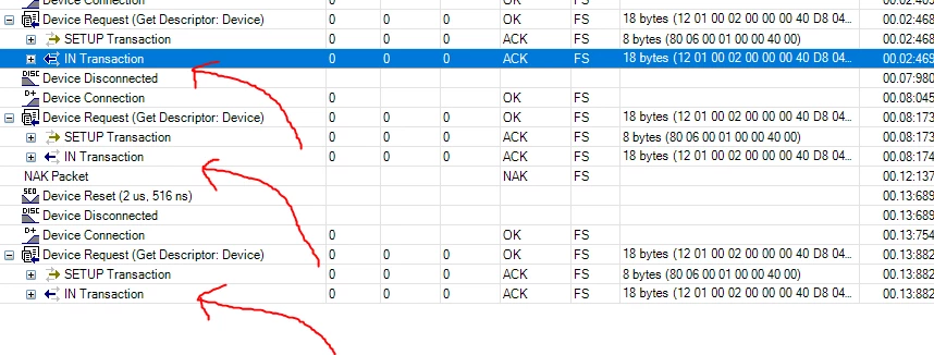

  1. Clear the CTR_TX flag.
  2. Set STAT_RX/OUT to VALID, this should trigger the OUT transaction right?
Unfortunately it doesn't, does anybody have any ideas of what to check/try?
When I do the STAT_RX thing it does the following:
