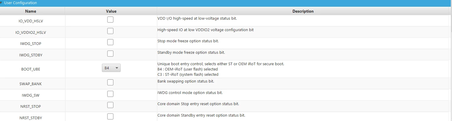

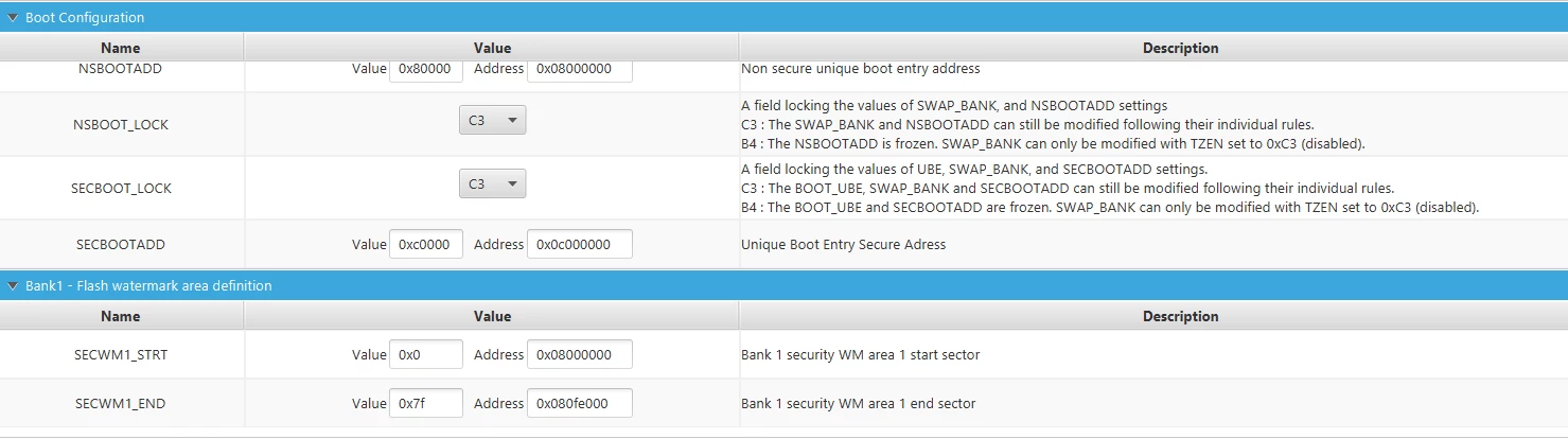

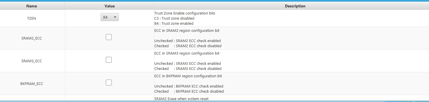

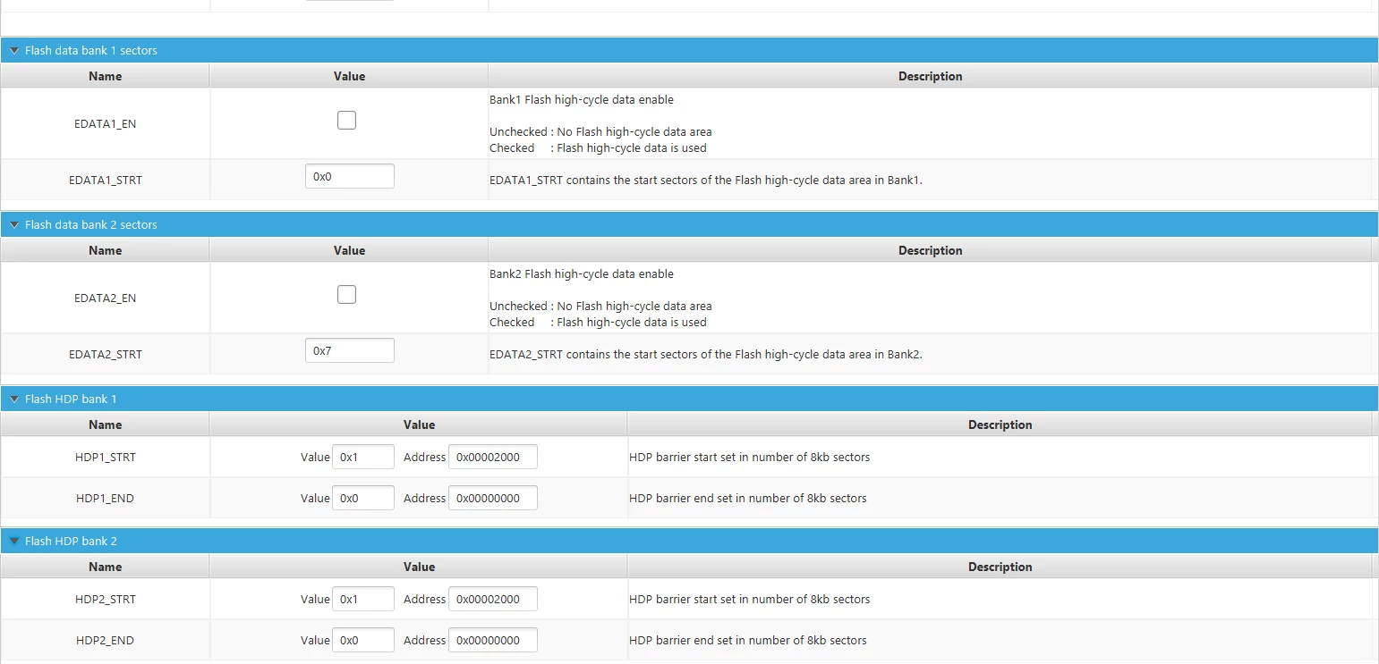

I am not able to run my FreeRtos in Non secure region when trust zone is enabled.

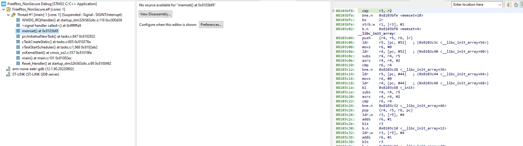

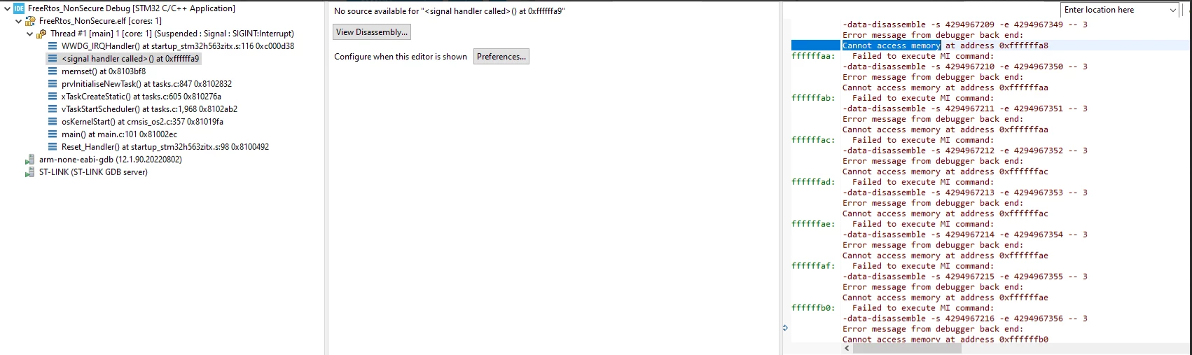

When I did the debugging it's going to the infinite loop ,getting message as "No source available for <signal handler called>() at 0xfffffffe"
Kendall7_0-1712057006924.pngKendall7_1-1712057026530.pngKendall7_2-1712057046381.pngKendall7_3-1712057071055.png
The above are the configuration setting I have enabled.
I am getting the above message when I did the debugging.
void MX_FREERTOS_Init(void) {
 /* creation of defaultTask */
 defaultTaskHandle = osThreadNew(StartDefaultTask, NULL, &defaultTask_attributes);
void StartDefaultTask(void *argument)
 /* USER CODE BEGIN defaultTask */
 /* Infinite loop */
 for(;;)
	 HAL_GPIO_TogglePin(LED_GPIO_Port,LED_Pin);
	 osDelay(1);
 /* USER CODE END defaultTask */
I am doing simple LED_toggle in FreeRtos task in Non secure region.
