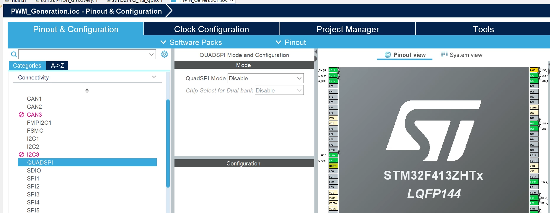

Hi i am using Nucleo - F413ZH i need to work on the QSPI protocol i found this device supports QSPI but in the repository i doesn't find any example code for this one is this device supports QSPI? or is there any similar sdk so that we can import projects form other repository

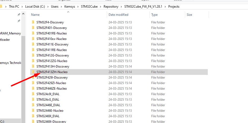

Hi can you check this repository where i have attached image
sorry for you confusion my point is QSPI sdk is present in the  STM32F413H-Discovery but my board is  Nucleo - F413ZH but in the repo of STM32F413ZH-Nucleo it is not present what my point is whether the device  Nucleo - F413ZH supports QSPI as i saw in STMcubeMX that peripheral was present

You are pointing to the NUCLEO board not to the Discovery board.
The NUCLEO board doesn't contain any external memory.
If you look for QSPI example running on STM32F413 device you need to check the example running on the Discovery board:

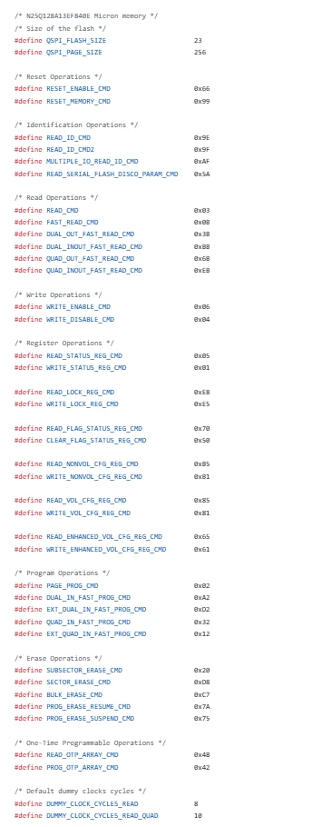

Hello @avinpat_8;
There are no QSPI examples for Nucleo - F413ZH.
Which memory is connected to the QUADSPI interface?
The QSPI examples are configured according to memory specifications.
The QSPI examples for STM32F413H-DISCOVERY board are tested with N25Q128A13EF840 micron, so you need to update the QSPI configuration in main.c and the command operation in main.h according to the memory you've used.
