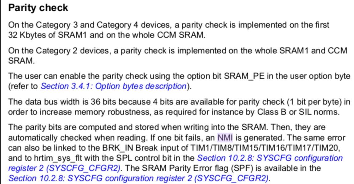

turbofishBest answer
Feb 18, 2025 1:09 PM UTC
Hi again,
We managed to solve the issue, but it still leaves some questions.
During the reset handler, where we zero out the BSS, and copy variables from flash to ram; we added a memory check (this was planned anyway) to see if there was any hardware fault. We write 0x55 and 0xAA (to test all bits) over the entire SRAM and then readback to verify that there was nothing funky happening and voila, no more NMI Faults. Parity was enabled in the option bytes from before. The check only adds a few ms to startup time.
From the datasheet:
Its only advised to do this, but it seems to be required in order to not have the NMI. Also, when the crash occurs the SRAM Parity Error Flag (SPF) in the SYSCFG_CFGR2 is most definitely NOT set.
If we turn off the SRAM Parity setting in the optionbytes, the system works as intended even without the RAM test.
So the questions are; is it required or is it advised to initialize the entire SRAM during startup to not have NMIs with parity turned on? And is there a check for a parity error except the Parity Error Flag, or should this maybe be in the errata?
Thanks for all the feedback folks!

turbofish
turbofishAuthorBest answer
Hi again,
From the datasheet:
