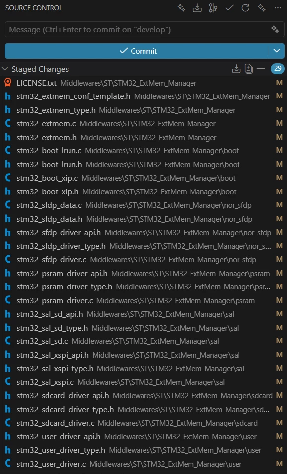

I've noticed that quite a few files have been changed, including the addition of #define EXTMEM_DRIVER_CUSTOM     0
In the conf_template, it could be helpful to understand what's changed. Everything else has stayed the same. Where should I look?

I've just found out that I've updated from SLA0044 Rev5/February 2018 to SLA0044 Rev6/October 2025

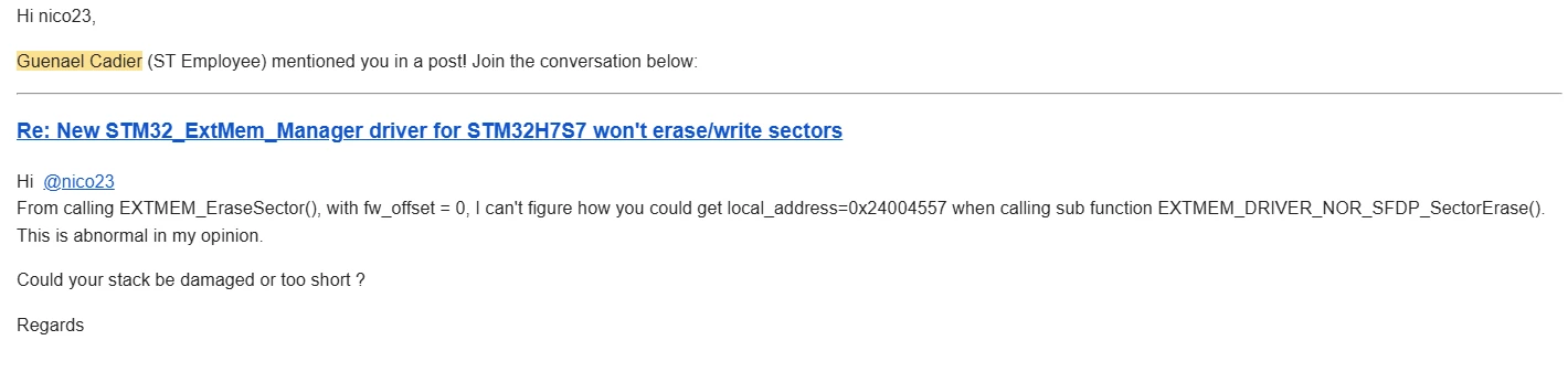

Hi ​@Guenael Cadier
for some reason your previous post was deleted by the migration (I guess)
I have increased the CTSACK and HEAP in my .icf from
define symbol __ICFEDIT_size_cstack__ = 0x1000;
define symbol __ICFEDIT_size_heap__   = 0x1000;
to
define symbol __ICFEDIT_size_cstack__ = 0x4000;
define symbol __ICFEDIT_size_heap__   = 0x2000;
but same issue

Hi ​@nico23
Thanks for recalling/recreating thread history.
Indeed, your original stack/heap sizes looks sufficient for running EMM MW in a classic application project. My original idea for requesting you to test extended sizes was related to your previous feedback, i.e. that you get local_address=0x24004557 when calling function EXTMEM_DRIVER_NOR_SFDP_SectorErase() with fw_offset = 0 as  EXTMEM_EraseSector() input parameter.
I don’t have any clue on how this could happen. Is there a project running on  STM32H7S78-DK board that you could share ?
Regards
