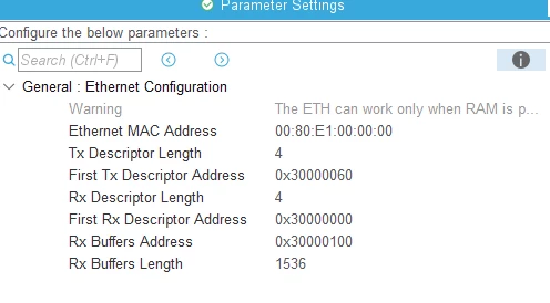

In the ethernet configuration, I setup the memory addresses as follows:
Note: it seems the RxBuffers Address is not used anywhere (correct me if I'm wrong, but I searched everywhere in the code and could not find it being used).  Anyway, the Ethernet descriptors were put at 0x3000_0000, and 0x3000_0060.

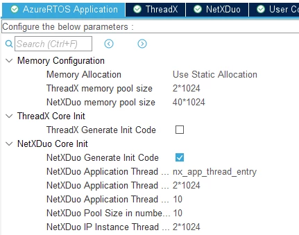

Under AzureTROS settings, I allocated 40k to the NetXDuo memory pool

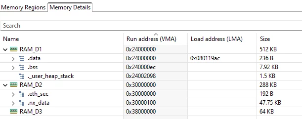

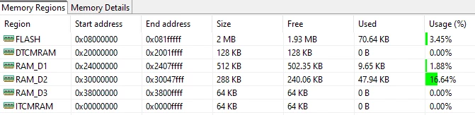

Now, I thought it compiled correctly - the way I wanted, because when I checked the detailed memory map,
.eth_sec and .nx_data were at the correct locations and have the correct size:

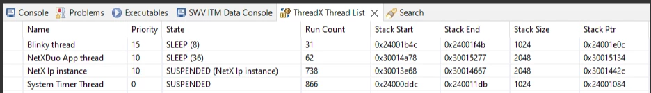

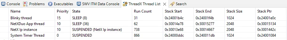

Then I noticed some weird things with AzRtos, it is putting the stack in RAM_D2 instead of where I expected (RAM_D1).  Any I have no idea how to fix this....
When debugging, I displayed the ThreadX list, and the 2 NetxDuo thread stacks are located at 0x3000_xxxx
This makes absolutely no sense to me, and can anyone explain what I did wrong?

Ok, I went through the NetxDuo code, and finally figured out what they were doing.  Everything associated with the NetxDuo, runs out of the .NetXPoolSection which includes the thread stack.  Anyway, now that I have a better understanding of the NetXPools, i was able to get it to work reliably.

All are created in one file.  The first 2 netx threads have the ThreadX stack in the middle of the NetxDatapool, and the Blinky task has the correct stack location.
The NetxDatapool has a size of 40K, and in this run / debug session,  NetXDatapool starts at 0x30010000.  Which means, I expect the datapool to end at 0x3001BFFF.
ThreadX put the stack for both threads 0x30013e68 and 0x30014A78
