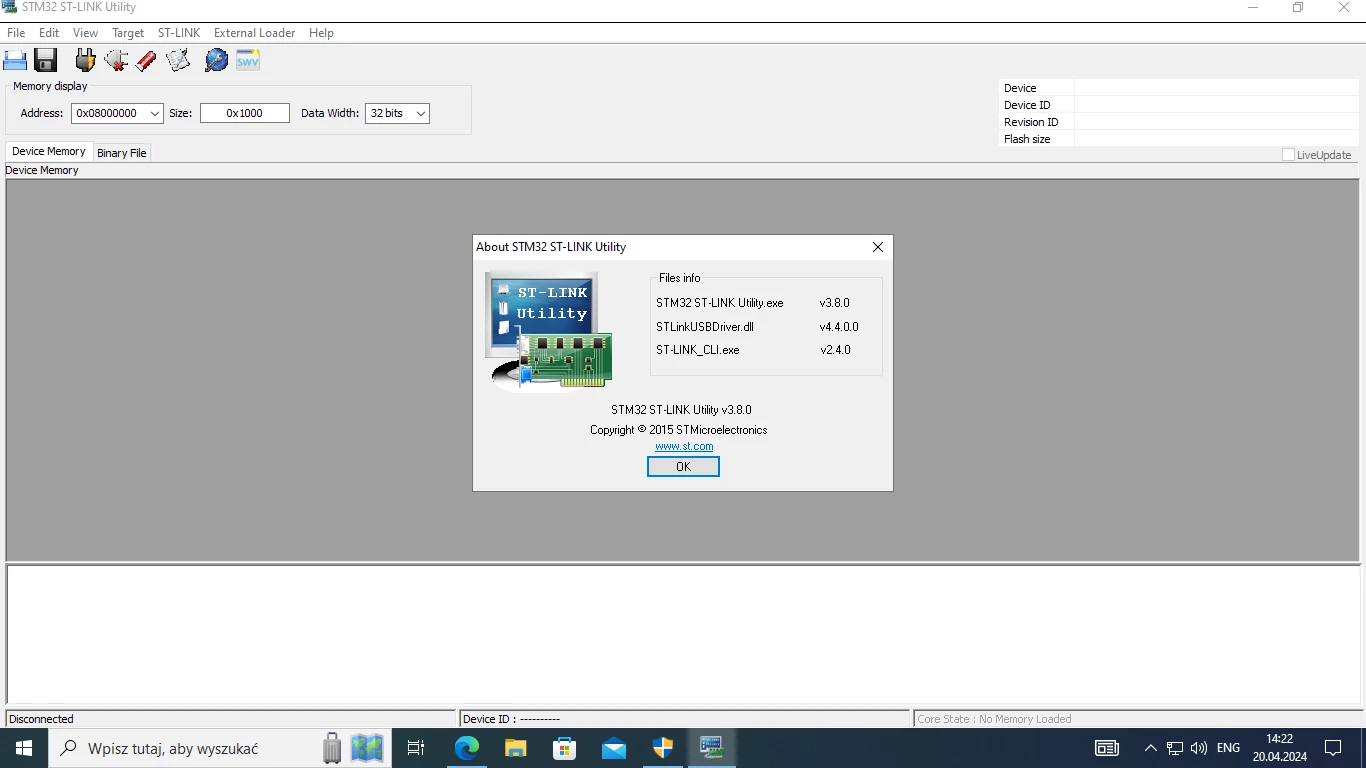

Kindly provide me the latest Firmware version for the above-mentioned Product along with the necessary instruction to upload it using STM32 ST Link Utility.
We are currently getting old firmware issues screenshot attached
Please assist us regarding this at high priority.

Hello @bh0pu and welcome to the ST Community :smiling_face_with_smiling_eyes:.
ST Link Utility is not recommended for new design. You should switch to STM32CubeProgrammer.

To upgrade the ST Link FW you need either to to use STM32CubeProgrammer or ST-LinkUpgrade utility downloadable from here. There is no other solution.
As stated above ST-Link utility is obsolete since a while and no more supported.

That's not how this woks.
What version ST-LINK ?
What NUCLEO board they make literally dozens of them.
There's a standalone app/download to update the ST-LINK's firmware can you use that? Or can't you be that flexible to solve your problem?

STM32L152 Nucleo-64
STM32 ST-Link Utility.exe V3.8.0
ST Link USB Driver.dll v4.4.0.0
ST Link_CL.exe v2.4.0

So rather old.
You only need to update the ST-LINK's firmware on one machine.
What error specifically are you seeing and what firmware version is on each of the ST-LINK's
The stand-alone ST-LINK firmware update tool can be found here.  https://www.st.com/en/development-tools/stsw-link007.html
ST-LINK Utilities are very old and deprecated, they are not going to see an update/upgrade. Time to move on, or look at Segger J-Link or pro-tools

If you have STM32CubeIDE, it will do the update automatically ...
