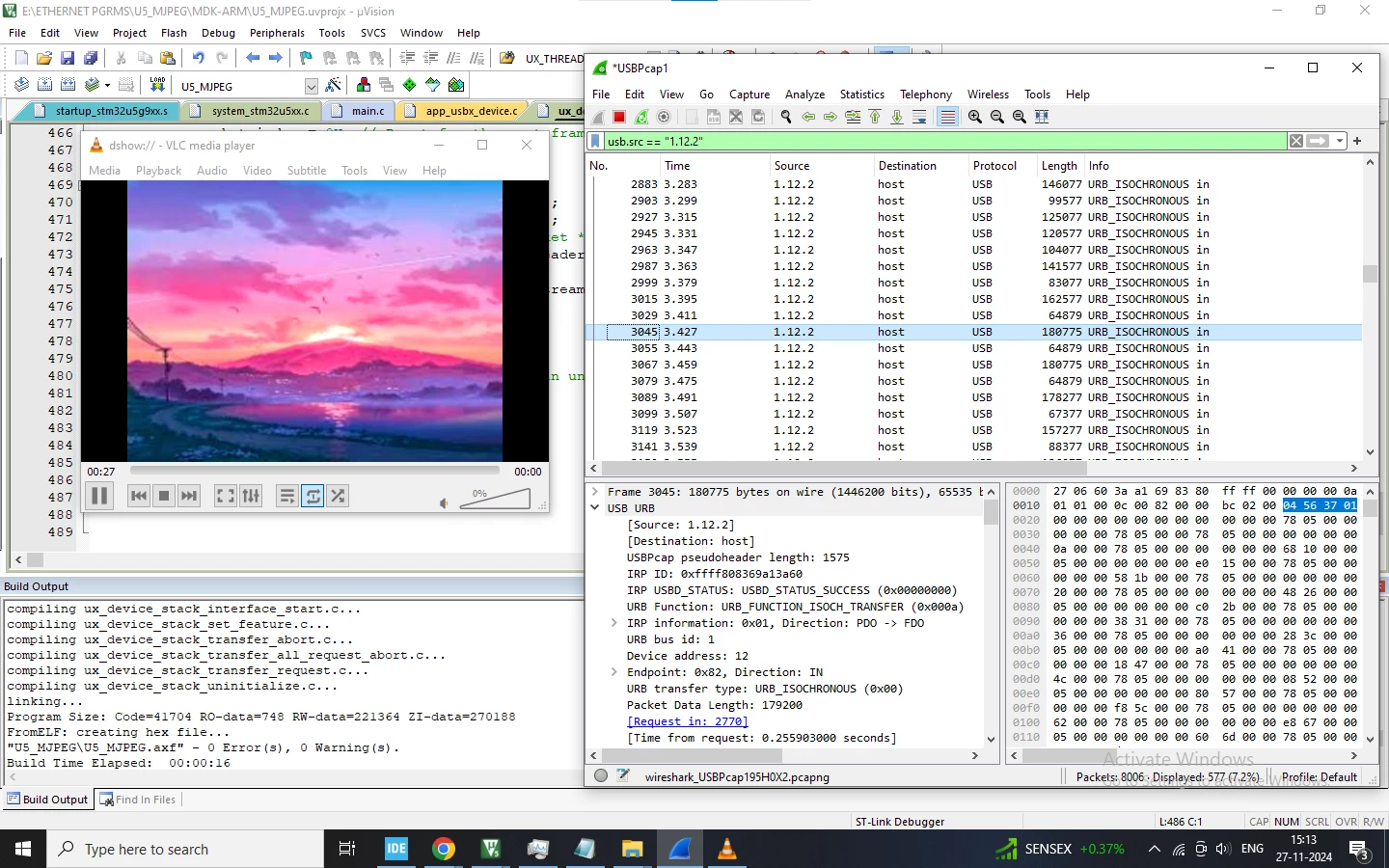

I’m reaching out with another issue I’m facing while implementing USB UVC (Uncompressed) on the STM32U5G9J-DK2 board.
The setup is working fine, and I can get image output with USBD_VIDEO_EPIN_HS_MPS under 1400U. However, when I try to increase the endpoint packet size by setting:
#define USBD_VIDEO_EPIN_HS_MPS 1400U
to a value greater than 1400U, the device stops being recognized in Device Manager.
For my application, I need to increase this value up to 5000U to achieve a higher data rate.
The problem is that the ux_device_stack_class_register  function in  MX_USBX_Device_Init()   returns UX_ERROR, which causes the code to get stuck in the following loop:
status = MX_USBX_Device_Init(memory_ptr);
if (status != UX_SUCCESS)
 while(1)
I’ve attached a ZIP file of my code for your reference, as well as a screenshot of the image output in VLC Media Player to show the current status.
Do you have any suggestions or ideas on how I can achieve this larger packet size or increase the data rate to meet my requirements?
