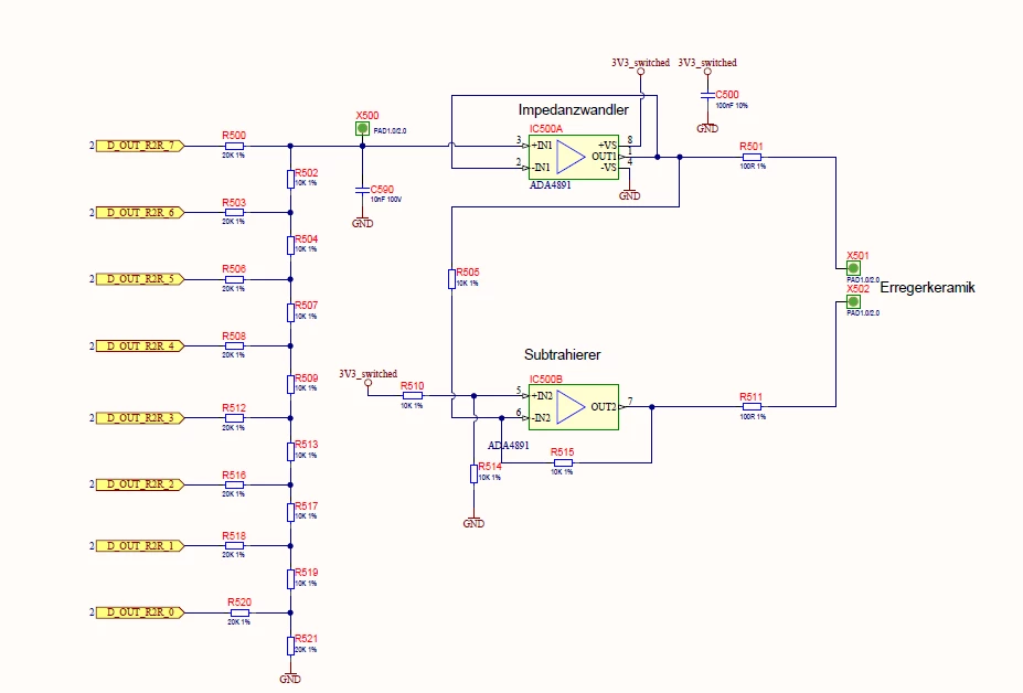

Hello Community,
I'm working on a project and could use your help. I'm trying to make a sine wave with a changing frequency from 600 Hz to 5 kHz using STM32 microcontroller(STM32L073RZT) with 32 MHz as sysclk.Capture.PNG

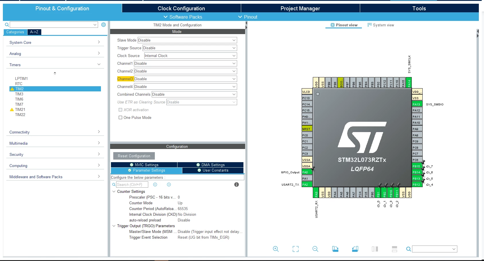

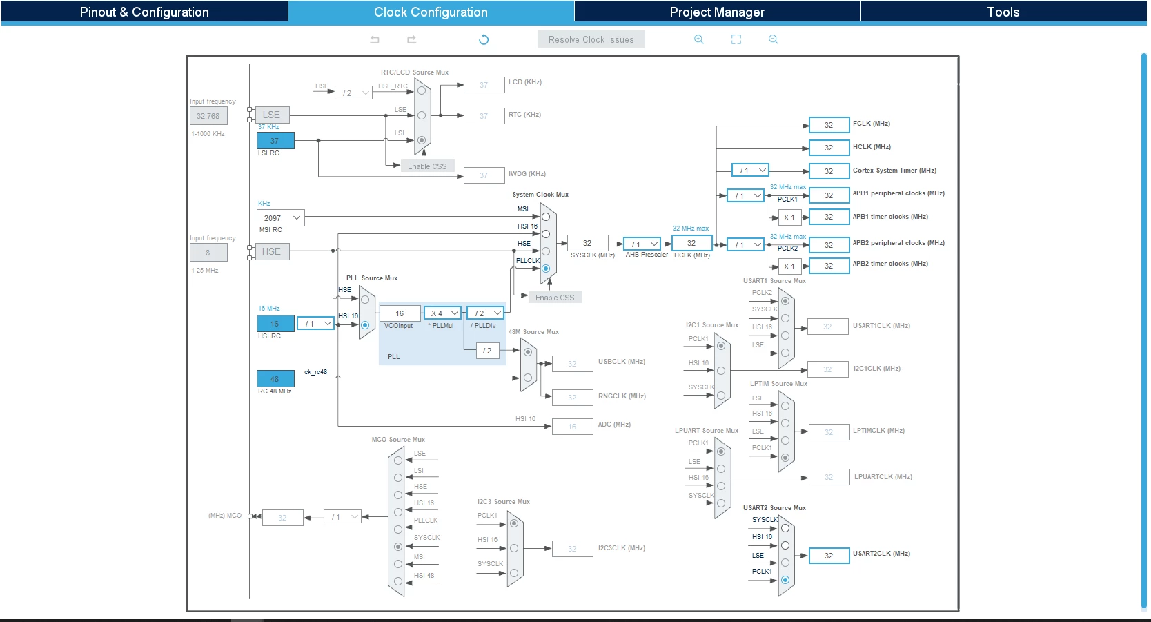

This are my configurations. Where this r2r pins are DAC bits.
I am not able to generate sine wave more than 280 Hz but i want to generate till 2 KHz.
Please suggest if I'm doing something wrong or if anyone has a good idea on how to overcome this issue.
