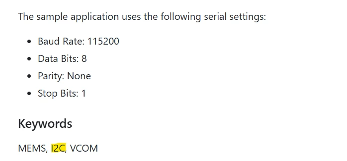

Could you please share example for using IIS2MDCTR via SAI on STM32U385.

I recommend you to look at DataLogTerminal example. This example shows how to use sensor expansion board to send sensor data from a Nucleo board using UART to a connected PC or Desktop and display it on generic applications like TeraTerm. After connection has been established you can also view data from various on-board inertial sensors as well like Accelerometer, Gyroscope and Magnetometer.
This example has been tested with NUCLEO-U385RG-Q RevC and X-NUCLEO-IKS5A1 boards.

IIS2MDCTR provides I2C and SPI interfaces.
SAI on STM32U385 is its Serial Audio Interface - I don’t see that this supports either I2C or SPI ?
