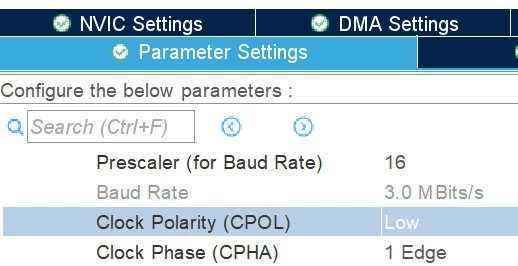

1.  Can we run the two board demo you mentioned, we have one NucleoF401RE and several Nucleo F103RB?
2.  In MX, ST SPI CPOL and CPHA (1_EDGE, 2_EDGE), how it corresponds to different terminology used by some sensor datasheet, mode 1 to mode 4, or mode "00", "11"
3. For SPI and I2C GPIO pin, how to select maximum output speed for a given SPI/I2C clock rate (i2C 100kHz, SPI 3 to 8MHz)?  Does it set drive current to control slew rate to minimize generated RFI interference?  Will setting to excessive "very high" produce ringing in signal?
What is 'fast mode' tick box on some but not all GPIO pin?
Many thanks
Sep 12, 2024 5:07 PM UTC
Hello @David_,
(1) You can run the two-board I2C communication demo using the Nucleo-F401RE and Nucleo-F103RB boards. However, you will need to make some adjustments.
(2) and (3) STM32 Reference Manual  : provides detailed documentation on SPI and I2C modes:
  • Understand the CPOL and CPHA values to configure the correct SPI mode.
  • Select the appropriate output speed based on the communication protocol's clock rate
 Fast mode is not linked to GPIO, but to I2C. The fast mode is the frequence range from 100Khz to 400Khz.

waclawek.jan
Sep 13, 2024 11:22 AM UTC
Thanks, this explains it.
A little bit clumsy, but at least the values are there.
Many many years ago, when I first came across SPI, that material put it in this way: CPHA=0 -- sample, then shift; CPHA=1 -- shift, then sample. I find this to be a concise description up to this day. This of course was in the times when familiarity with hardware (here shift registers, as SPI is nothing but) was a given amongst mcu programmers.
