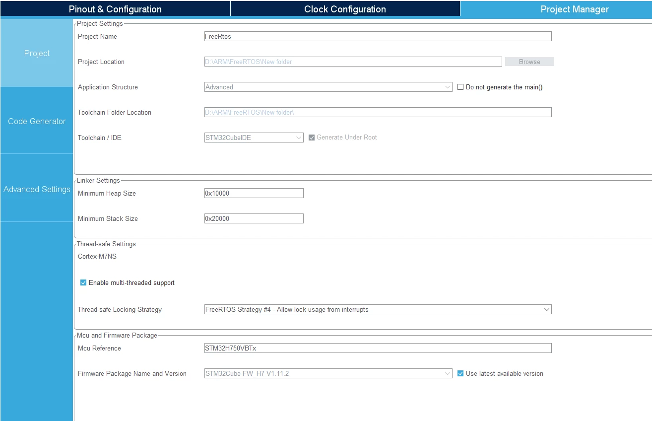

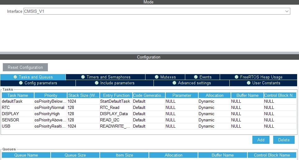

Jul 6, 2024 5:22 AM UTC
Hello @nouirakh
I increased the stack size and heap size as you can see. and also change the default task that MX_USB_HOST_Init(); is in there. but nothing happened.
Is this the place to increase stack size that you mentioned?
ap size in

Jul 8, 2024 8:46 AM UTC
Hello @unknown
You can change the stack sizes using STM32CubeMX by following these steps:
  • Go to the "Middleware" section in the left-hand pane.
  • Click on "FreeRTOS" to open the FreeRTOS configuration settings.
  • In the FreeRTOS configuration window, you will see a list of tasks.
  • For each task, you can set the stack size. Click on the task you want to modify. In the properties pane, find the "Stack Size" field. Enter the desired stack size for the task.

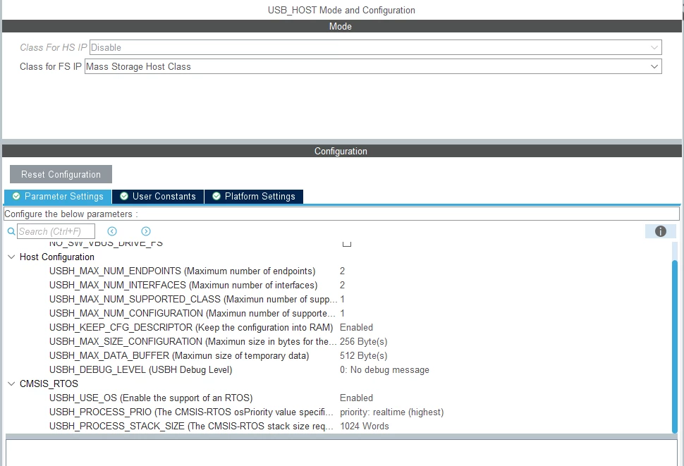

Jul 8, 2024 9:18 AM UTC
thankyou @nouirakh for reply
I Increased the stack size as you mentioned but randomly have trouble again.
beside that I change task priority and likewise I wrote random stuck in initializing. but somehow after 5 or more reset it pass to run program. after that I can't read or write USB like when I use USB_MSC in superloop mode. (I mean "usb_host.c" file)
I have some question for be sure that I have no bug on Cube IDE.
1. is there any visible task when generating code for USB_USE_OS?
2. Do I need function to run USB in tasks?
3.this is code generated Initializing USB is it ok?
and more to ask :)

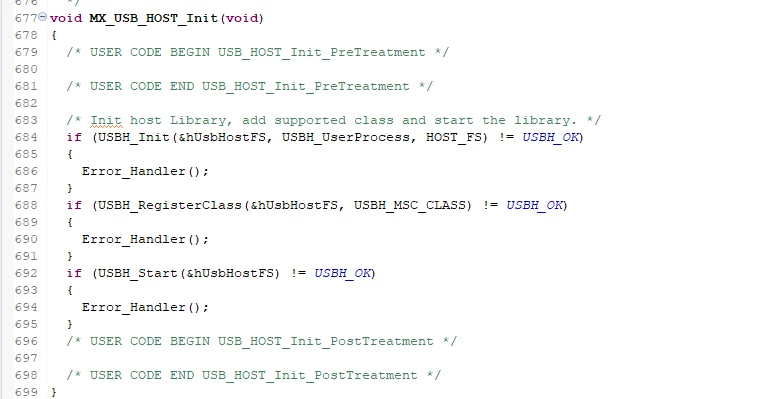

Jul 8, 2024 10:32 AM UTC
Thankyou @nouirakh
the Code Below show all script of my "usb_host.c" that code generator made it.
So this is the problem. code generator has bug for me. I am using CUBE IDE 1.15.1. what should I do for this issue? or should I add some code manually into it!

nouirakh
nouirakhBest answer
Jul 8, 2024 10:53 AM UTC
@unknown
The USBHProcess function is empty, it can cause problems. The USBHProcess function is responsible for handling the USB Host stack's state machine and processing USB events. If this function is not implemented correctly, the USB Host stack will not function properly, leading to issues such as the inability to detect or communicate with USB devices.
I think to ensure proper USB Host functionality, the USBHProcess function must call USBH_Process periodically. This allows the USB Host stack to handle events and manage device communication effectively.
