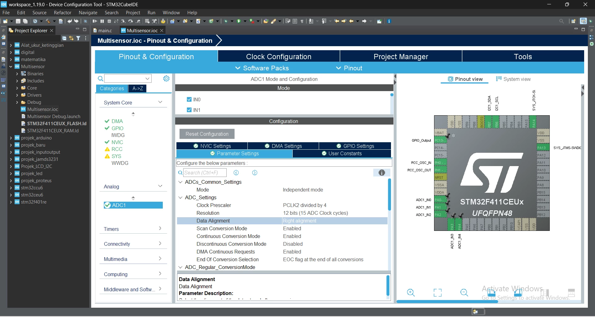

What is the correct way to implement multiple ADC channels? I have tried various tutorials on YouTube, but none of them work correctly. I am using two potentiometers. The ADC readings are random and cannot be controlled by the potentiometers. At one point, I managed to get it working, but only one potentiometer responded. The second potentiometer did not work, and the value of Channel 2 followed the value of Channel 1, even though Channel 2 should be controlled independently by the second potentiometer.

A single ADC can convert only one channel at a time.
To read two potentiometers, enable Scan Conversion Mode and set Number of Conversions = 2.
Assign each potentiometer to a different ADC channel and give each one its own rank.
If you need continuous updates, enable Continuous Conversion Mode.
Please You can refer to ST’s ADC_MultiChannelSingleConversion example.
It shows how the ADC scans multiple channels in sequence.
Then adapt the same configuration to your STM32F411CEU6 board.
