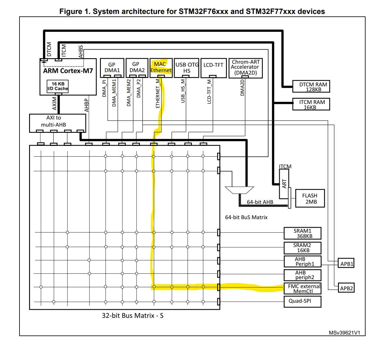

I am using an STM32F767 with MQTT, and everything works without using TLS. But when I try to enable TLS, it fails to connect to the server because of a memory issue (calloc fails). I read other message boards that state that I need up to 60K of RAM to use TLS (this seems excessive). What are the correction options for configuring stm32F767 when using TLS? Thank you in advance.

SRAM2 is used for ethernet buffer which is 16K.
I have an external SDRAM (FMC interface) currently being used for a display buffer with plenty of space available is it possible to configure it to use as the buffer?

Regarding "I have an external SDRAM (FMC interface) currently being used for a display buffer with plenty of space available is it possible to configure it to use as the buffer?"
if you meant using the SDRAM via FMC interface for DMA buffers and descriptors yes this could be done
