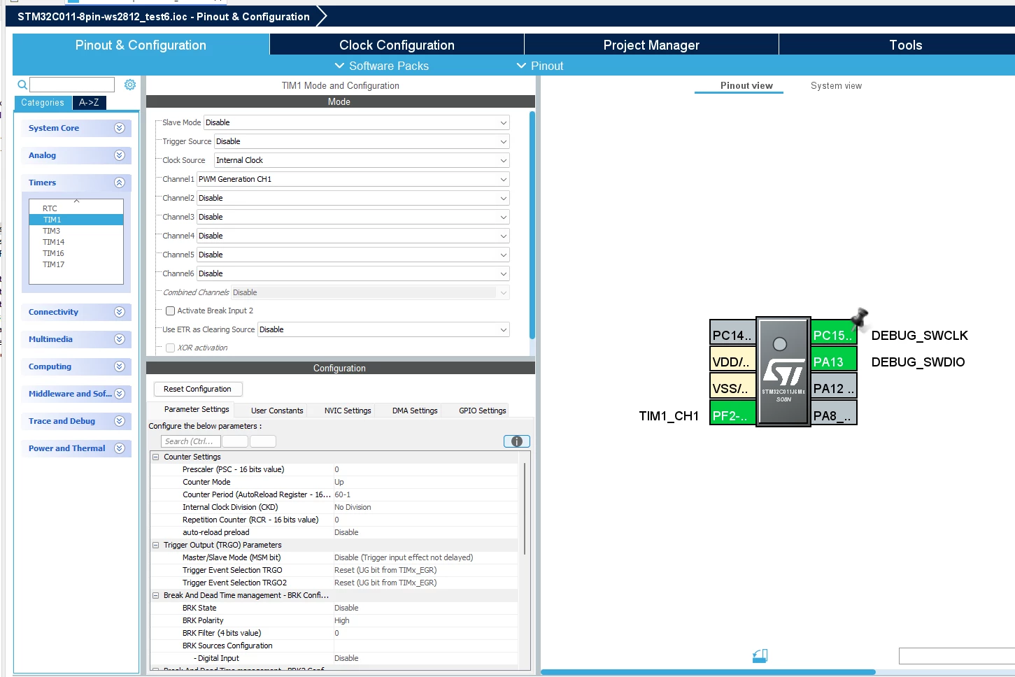

I have a breakout board, I've been testing some ws2812 code , I'm using  TIM1 with DMA + PWM
I developed the code on the G030, it's a 32 pin package.
I'm using internal clock and have it running at 48MHz for Timers.
Works has intended.
Switch to C011 in an 8 Pin package.
Created new project in MX and just copied over the code I added.
Code does not work.  complies fine, but the leds not work.
In both porjects I am using TIM1 , configured the same way.
I don't have a Scope where I can view the PWM output
Question:  Does anyone of a any differences between how TIM1 works between both MCU? I looked through  AN5969   Migrating between STM32G0 and STM32C0 MCUs  and nothing jumped out.

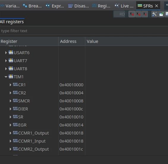

Apr 28, 2025 1:02 PM UTC
It should work...if compiler shows no warnings...?
to check, the tim/pwm setting: just stop it in debug and look at sfr -> tim1 , to see, whats it doing:

basically  I first create an array  of  color (rgb) data for 7 leds, in the correct order
color = ((LED_Data[i][1]<<16) | (LED_Data[i][2]<<8) | (LED_Data[i][3]));
then from this array , i create an second array to hold the pwm data to be sent via DMA.
for (int i=23 ; i>=0; i--)
if (color&(1<<i))
pwmData[index] = 40; // 2/3 60 using 48MHz clock with AAR of 60 800KHz
else pwmData[index] = 20; // 1/3 of 60
index++;
for (int i=0; i<50; i++)
pwmData[index] = 0; // add some zeros at the end to flag end of transmission
index++;
HAL_TIM_PWM_Start_DMA(&htim1, TIM_CHANNEL_1, (uint32_t *)pwmData, index);
while (!datasentflag){};
datasentflag = 0;
This works fine with the G030, nothing or random leds light up with the C011
Both MCU are using a 48MHz timer clock. 0 Prescaler and an arr of 60 to give 800KHz timing
C011:
htim1.Instance = TIM1;
htim1.Init.Prescaler = 0;
htim1.Init.CounterMode = TIM_COUNTERMODE_UP;
htim1.Init.Period = 60-1;
htim1.Init.ClockDivision = TIM_CLOCKDIVISION_DIV1;
htim1.Init.RepetitionCounter = 0;
htim1.Init.AutoReloadPreload = TIM_AUTORELOAD_PRELOAD_DISABLE;

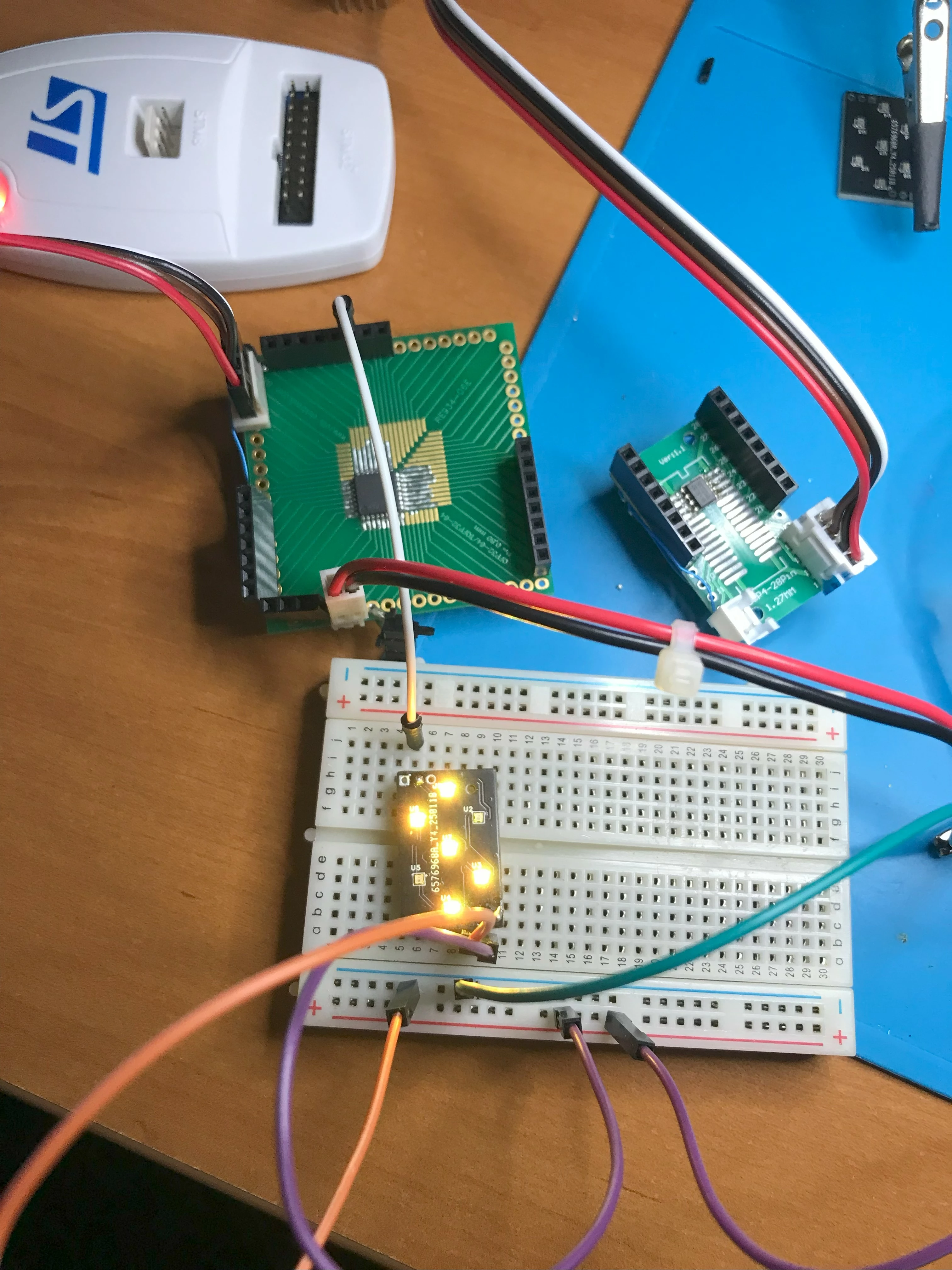

Apr 30, 2025 9:39 AM UTC
This is my basic setup, I just swap the 2 break out boards, same leds , using a bench powersupply at 3.3 volts ,
I preformed all my original testing with the G030, with the C011 , I have only run basic led toggling code. before trying to move my code from G030 to it.
All done with the CubeIDE, just configured a new project for the C011
, Then used the IDE's compare file feature to code over my parts of the code from the G030 main.c, not using any libraries or extra .h .c files.....
Hmmm, maybe I should double check I have  selected the right C011?  apart from Flash sizes, is there any difference in timer operations between submodels to the same main MCU type?

KnarfB
May 1, 2025 7:04 PM UTC
What you have shown looks okay.
Can you set that pin statically to 0 and 1 and measure the output level, i.e. a classic blinky? Could it be a soldering issue?
hth

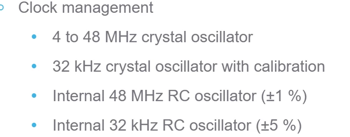

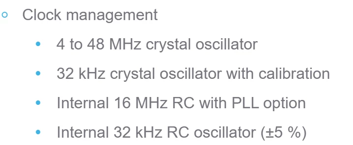

MM..1
May 17, 2025 10:41 AM UTC
You can miss many thinks, but primary read first carefuly about mcus.
C011
G030
no PLL vs PLL usw.
