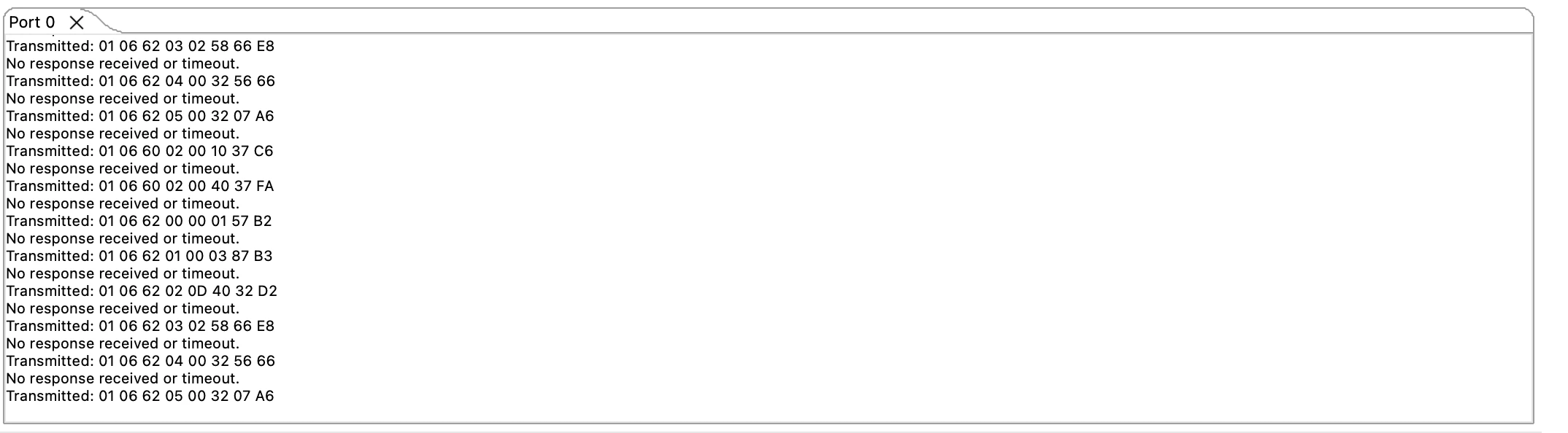

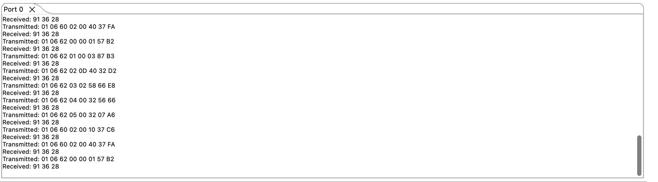

2 replies
mƎALLEm
Oct 3, 2024 7:51 AM UTC
Hello @tnishanthraj ,
Why there is this delay of 2 second between the transmit and the receive? there is a big risk to lose the response from the AC servo mainly if it answers to your request in less than 2 seconds.
And I suggest to remove this "big" delay and use Rx interrupt instead.
Oct 3, 2024 9:21 AM UTC
Hello! I used Rx interrupt and I've attached the output I got. I'm still not getting the desired output. But I did some troubleshooting and found out that the PA1[RSE] pin isn't getting HIGH. I used a multimeter. But in general, I wrote a program to toggle PA1 and it worked just fine.
