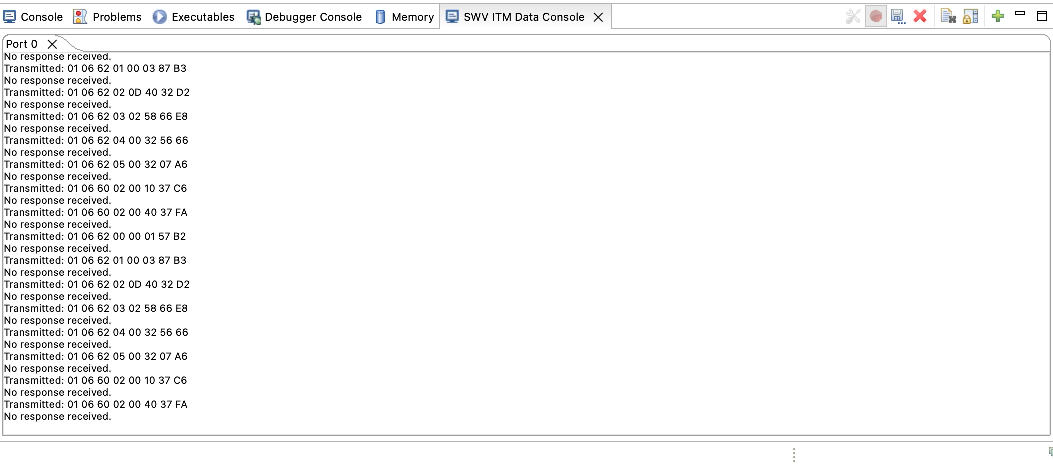

Hello everyone,
I’m working on a project where I’m using a NUCLEO-F446RE board to control an AC servo drive via MODBUS RTU. I’m using a TTL to RS485 converter to handle the communication. The problem I’m facing is that I get no response from my servo drive when sending MODBUS RTU frames from the NUCLEO board.
I’ve already tried the same setup using an Arduino Mega, and everything works perfectly – I can communicate with the servo drive and control it without any issues. So, I believe the issue might be with my program or the way MODBUS RTU is being handled on the NUCLEO board.
Here’s the setup I'm using:
  • Controller: NUCLEO-F446RE
  • Converter: TTL to RS485 converter
  • MODBUS Communication: USART1 (PA10 Rx, PA9 Tx, PA8 DE, PA7 RE)
  • Servo Drive Baud Rate: 38400, no parity, 2 stop bits
I’ve attached my program below, and I’d appreciate it if anyone could help me identify where the issue might be.

And i've attached a image of the output i'm receiiving.
Thank you!

Senior III
Sep 26, 2024 1:13 PM UTC
Arduino ttl is 5V. So if your ttl to rs485 is 5v type, the transmitted data may not be correct. What you can do is to connect another rs485 parallel and read the data to know if the transmit is good or receive is good.
If you can do the receive using interrupt,  it's better since we don't know the exact time at which the response is received
